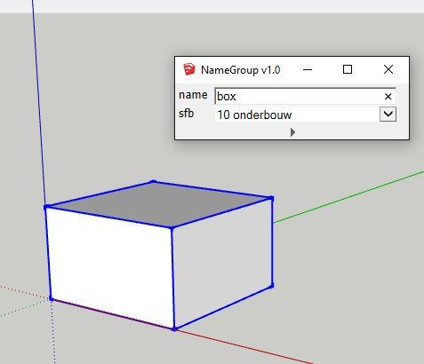

I have s small plugin that allows me to group a selection and type in a custom name OR choose a name from a dropdown list. At the start of the tool the textbox is activated with document.getElementById("textbox").focus();
In V15 it works as intended. In V16, SketchUp often steals focus while I’m typing and then the keypresses are activating tools. Is there any way to prevent SketchUp to steal focus?
