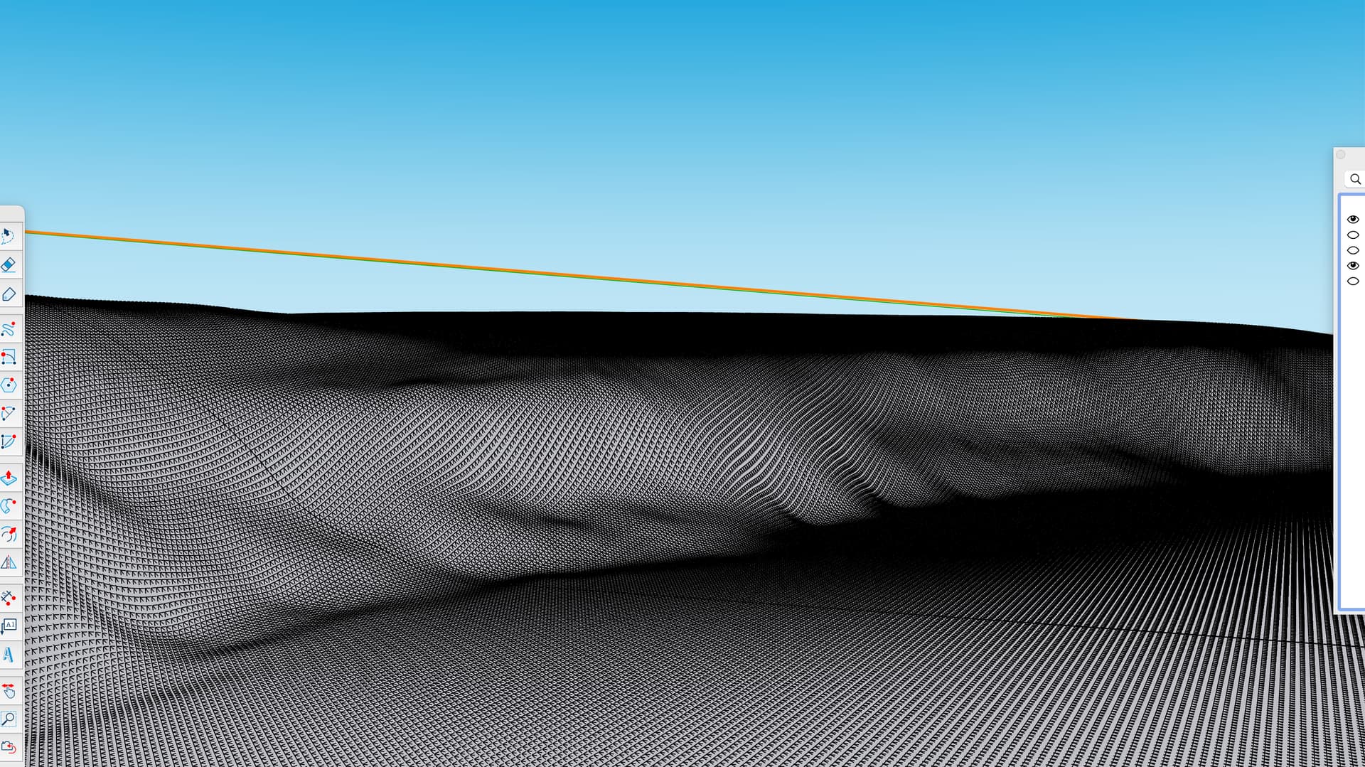

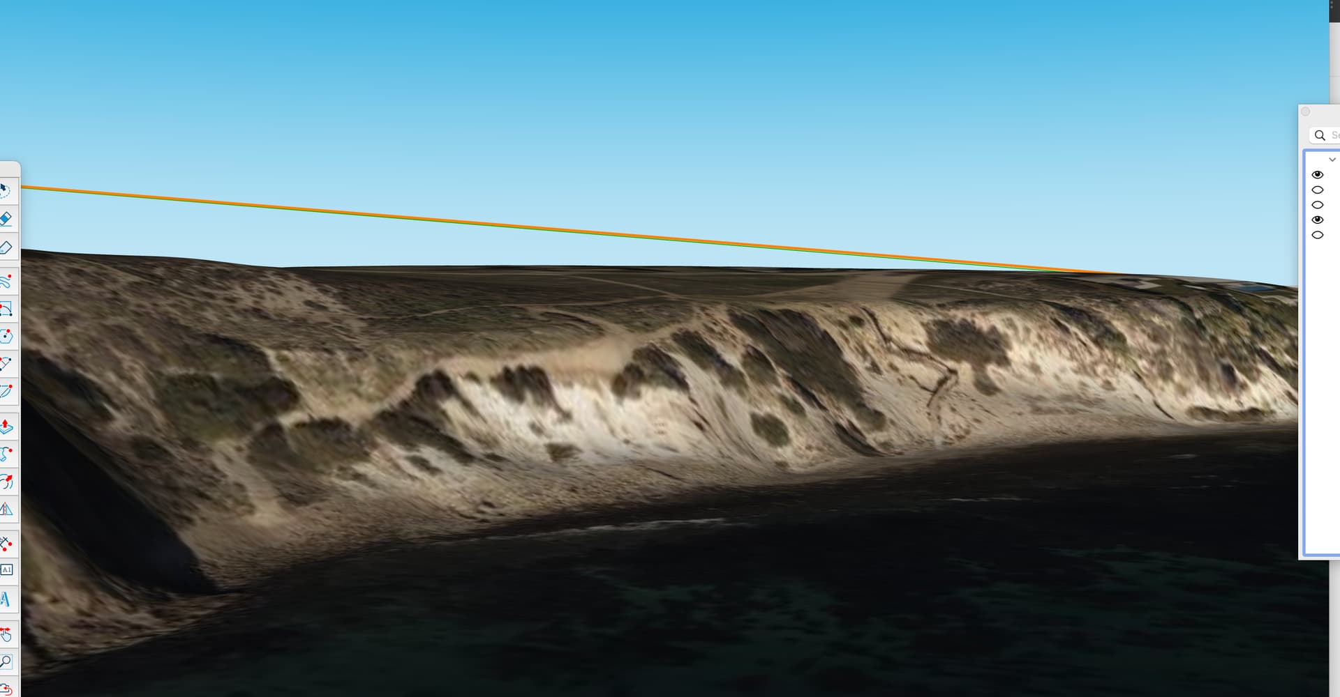

Before calling it quits, I’d recommend you experiment with my Heightmap method - what I use almost exclusively now as I too have not been able to get what I want out of Add location and don’t want to pay for Placemaker - Explanatory video: https://www.youtube.com/watch?v=PSfjSsF4_QA
Hi Eric, great walk-through video of your workflow, and for larger areas or for different satellite imagery it is very useful.
It shouldn’t be needed any more for getting higher resolution though, it looks like you are using the old add location which had limited terrain options, we support higher resolution meshes now (released with 2024.0)
e..g I have tried to match the camera position in your video at https://www.youtube.com/watch?v=PSfjSsF4_QA&t=92 at high resolution mesh from Add Location:
