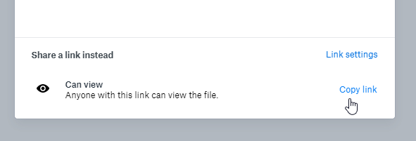

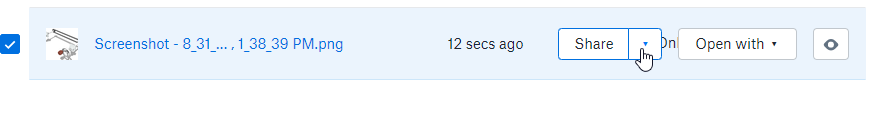

Click on the Share button (not the down-pointing arrow next to it.
At the bottom of the window that opens, click Create link.
Screenshot%20-%208_31_2019%20%2C%202_40_52%20PM
Then click Copy link.
Screenshot%20-%208_31_2019%20%2C%202_41_04%20PM
And paste that link in your post.

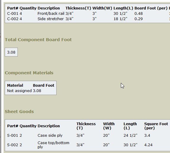

Here I’ve taken the liberty of making all the parts 3/4 in. thick and used components (copied as appropriate). I set units to decimal to show the components are accurately modeled.
And the cutlist shows parts that can be easily produced in the shop.

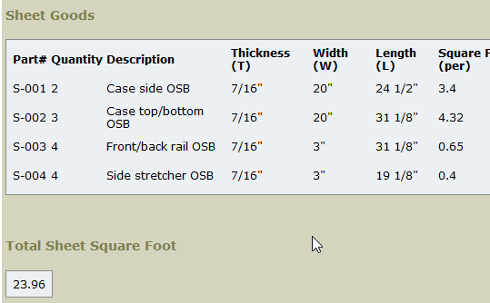

So you’re building the thing out of 7/16 in. OSB? No biggie. With the components as I’ve drawn them, those dimensions can all be changed easily.
