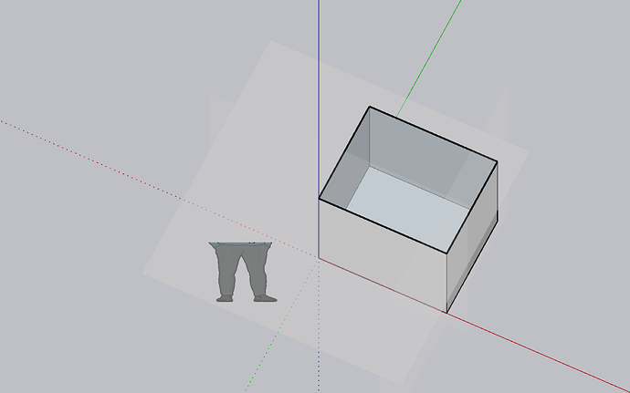

I am fairly new to using section cuts, so I must be doing something wrong but when I use section cuts it does not show the grip points or the section cuts. Everything is switched on in the styles as well as in the view.

Hey thanks for the quick respons,
File added below.
I did check the engine, it is only with the new one that it doesn’t work, it does work with the old one however.
Do you think I can’t use the new engine? And does this have any negative consequences?

Capture d’écran 2025-10-23 à 13.55.49
yeah, looks like your GPU is too weak to handle some of the new engine parts. the sections, in this case.
https://help.sketchup.com/en/sketchup/system-requirements
technically some integrated GPUs (intel iris and such) are compatible but they won’t necessary handle the pressure.
overall, sketchup pro requires (more and more) a dedicated GPU to run with the new engine. luckily enough, for now at leaqt, it’s still shipped with both engines. you can switch when needed.
Thanks a million for the solution !
