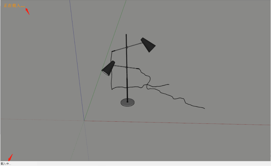

Screen display text
When loading the model, the screen will be gray and prompt text will be displayed on the screen. After loading, the screen will exit the gray function and text will be cleared.I tried draw_text but it didn’t work and add_note wasn’t what I wanted。I tried transparent HTML to do this but I don’t know why transparent styles don’t work

I’m sorry, I misunderstood you.This is the rendering of this function.
