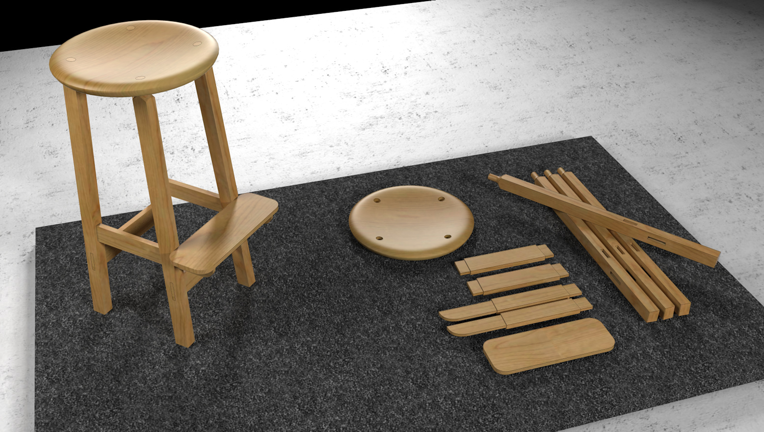

Loosely based on a loom stool from about 1840. The footprint of the original is wider than the seat. I reduced the rake and splay for this one. Parts for a second one ready for assembly.

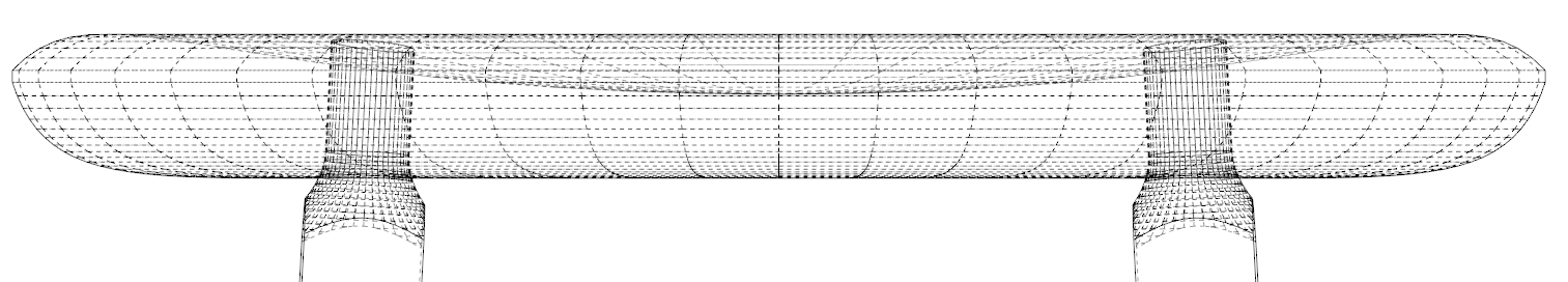

EDIT: how did you make the shape of the seat? if it’s not too much to ask.
Might reduce the probability of falling over
I’m sure that’s why it was done back then. This is a pretty simple model. I might draw a new version with the splay set up to match the original stool.
I would bet it’s a simple follow-me?
Sorry. I missed your edit.
Cotty is absolutely correct. Nothing complicated at all.
This render shows the grain a little better.
Cool, the idea that came to my mind was more complex and with a worse result. thank you for sharing the idea.

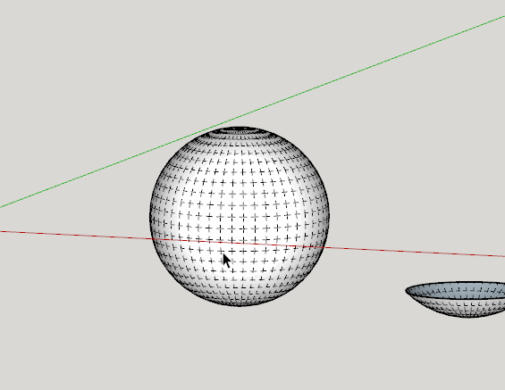

By the way, the think I thought the seat was made was something like this (it’s only to show how I make “easy” things more complicated, I know it doens’t look alike), don’t worry about the .gif I understood the explanation about how you did it using follow me tool.
