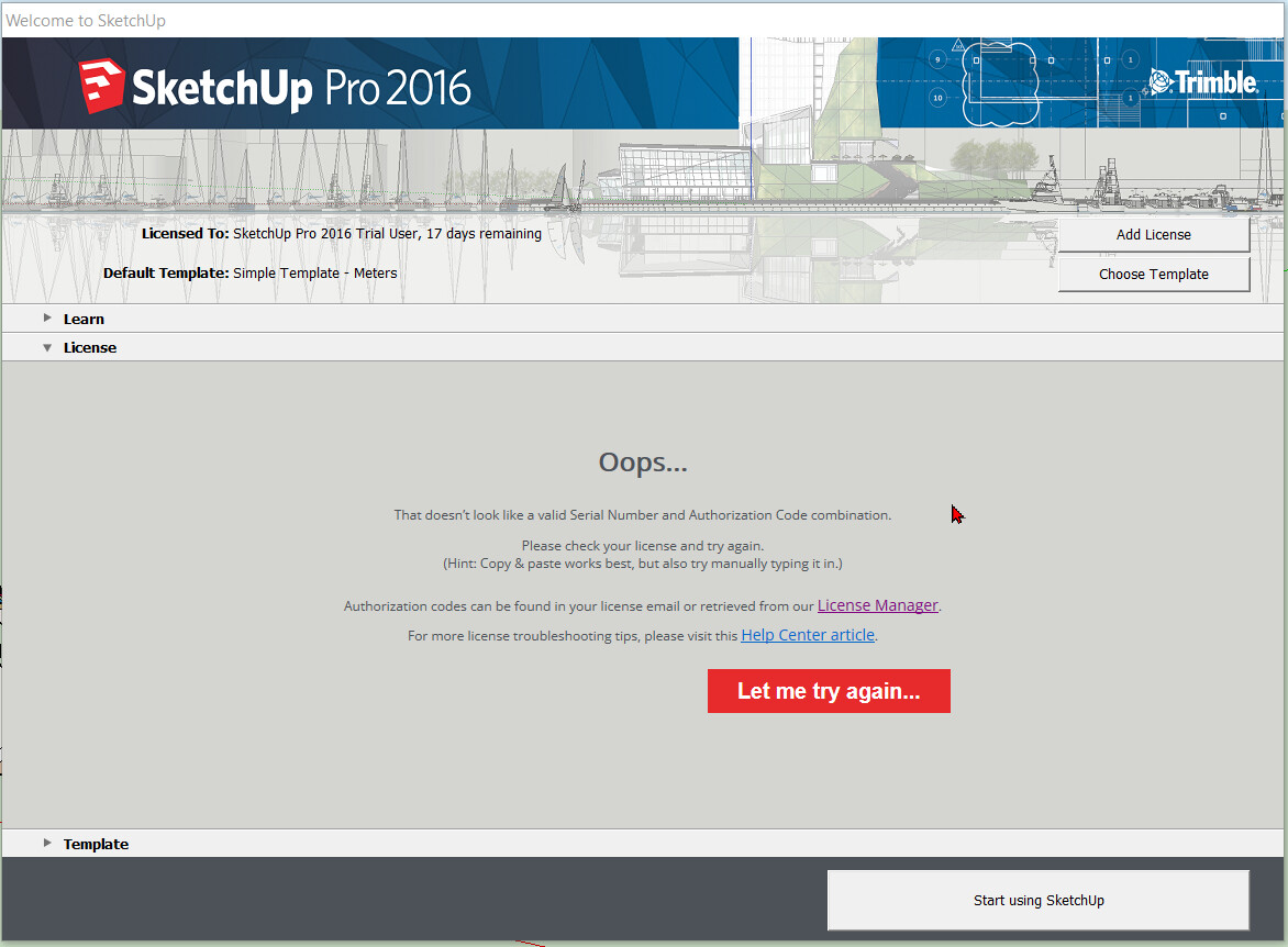

I found out i DO have a SU2017 license when my SU2016 workaround started to work…
The server responded that my lic. seems not to be valid… (Aha, seems i upgraded, and forgot about it.):
The “License Manager” link still works, and based on the old serial it could tell me the new one and mail me the auth.nr.
So, it looks like activating on SU2016 would work too, but i could not test, since my 2016 lic. is no longer valid after i upgraded it to 2017…

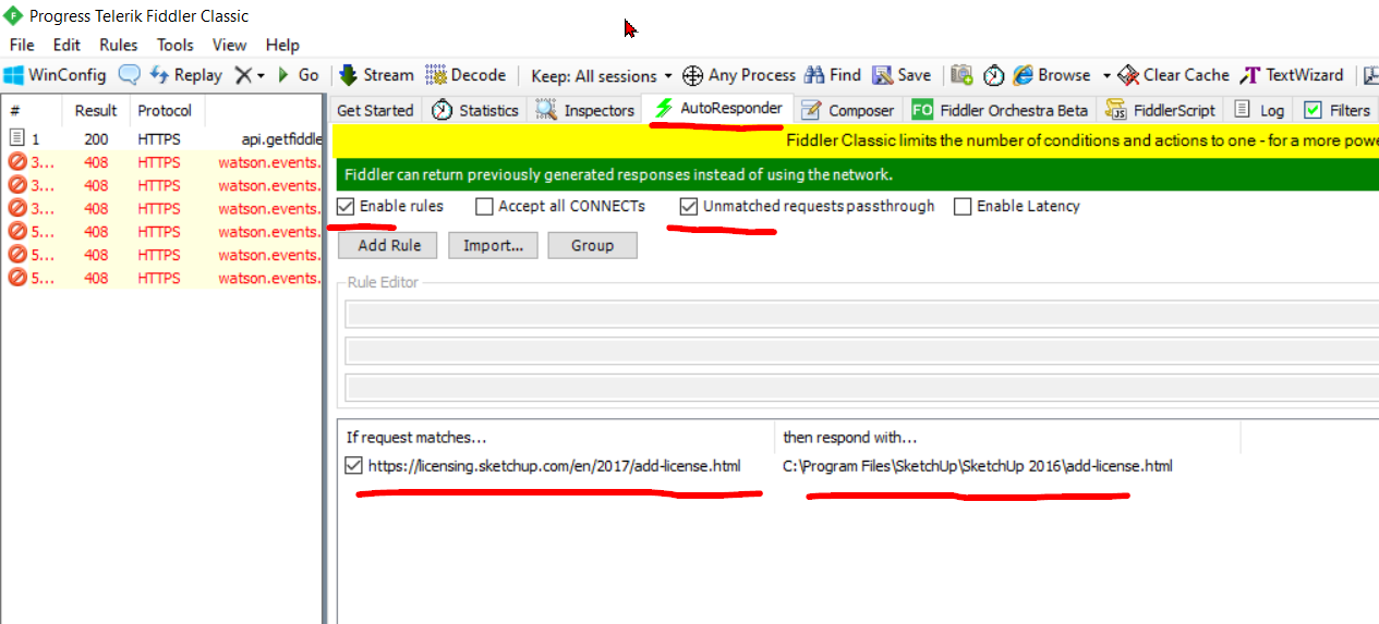

  1. You need to use a tool like Fiddler.
    It can intercept SU’s request to the license server and respond with a local file, in which we fix the issues of the original file:
  2. The local file is a modified version of the one originally returned by the server.
    The modifications:
    Mainly, the code of the linked addLicenseV2.js which only works on EDGE is replaced by IE-compatible equivalent code. Gemini was able to create that 1st try… (It is directly embedded in the html doc to avoid https errors when loading from file://).
    I also removed google tag manager and changed urls from relative to absolute. That’s all i think.

      var license = '{"serial_number": "' + serialNumber + '",' +
        '"auth_code": "' + authCode + '",' +
        '"su_version": "' + version + '",' +
        '"host_id": "' + host + '",' +
        '"os_user_name": "' + os_user_name + '"}';
      if (validateInput()) {
        var request = $.ajax({
          data: 'input=' + license,
          dataType: 'json',
          timeout: 15000,
          type: 'POST',
          url: window.location.hostname === 'licensing.sketchup.com' ?
              'https://api.sketchup.com/licensing/v1/activate' :
              'https://stg-api.sketchup.com/licensing/v1/activate'
        request.done(function(data) {
          switch(data.response_code) {
            case 0:
              var license_file = data.license_file;
              license_file = license_file.replace(/(?:\r\n|\r|\n)/g, '%0A');
              license_file = license_file.replace(/\\/, '%5C');
              window.location.href = 'skp:addLicense@' + license_file;
              break;
            case 1:
              $('.dialog-box').hide();
              $('.license-info').addClass('invalid');
              $('#invalid-license').show();
              break;
            case 2:
              $('#machine-limit').show();
              break;
            case 3:
              $('#expired-license').show();
              break;
            case 4:
              break;
            case 5:
              $('#incompatible-license').show();
              break;
        request.fail(function(jqXHR, textStatus, errorThrown) {
            switch(textStatus) {
              case 'parsererror':
                break;
              case 'abort':
              case 'error':
              case 'timeout':
              default:
                $('#network-error').show();
        request.always(function() {
          $('#ajaxBusy').fadeOut();
  function obscureFields() {
    var serial = $.QueryString['serial'];
    if (serial) {
      var oldSerial = $('#serial-number');
      var oldAuthCode = $('#authorization-code');
      var newSerial = $('<input>').attr({
        'type' : 'password',
        'id' : 'serial-number',
        'class' : 'license-info',
        'value' : serialNumber
      var newAuthCode = $('<input>').attr({
        'id' : 'authorization-code',
        'value' : authCode
      newSerial.insertBefore(oldSerial);
      newAuthCode.insertBefore(oldAuthCode);
      oldSerial.remove();
      oldAuthCode.remove();
  //jQuery fix for placeholders in lte IE9
  $('input, textarea').placeholder();
  // Get the serial number from the query string
  $.QueryString = (function(a) {
    if (a === '') return {};
    var b = {};
    for (var i = 0; i < a.length; ++i) {
      var p = a[i].split('=');
      if (p.length != 2) continue;
      b[p[0]] = decodeURIComponent(p[1].replace(/\+/g, ' '));
    return b;
  })(window.location.search.substring(1).split('&'));
  var serialNumber = $.QueryString['serial'];
  var authCode = $.QueryString['auth'];
  var suVersion = $.QueryString['su_version'];
  var hostId = $.QueryString['host_id'];
  var osUserName = $.QueryString['os_user_name'];
  if (typeof serialNumber !== 'undefined') {
    $('#serial-number').val(serialNumber);
    $('#authorization-code').val(authCode);
  var urlPath = window.location.pathname.split('/', 3);
  var langCode = urlPath[1];
  var versionFromPath = urlPath[2];
  // 2019 and later use placeholder text instead of the background image.
  var suVersionNum = parseInt(versionFromPath, 10);
  if (suVersionNum <= 2018) {
    var bgImage = '#fff url(/images/' + langCode + '/bg-adv-license.jpg) center no-repeat';
    $('#adv-serial').css('background', bgImage);
    $('#advanced textarea').on('focus', function() {
      $(this).css('background', '#fff');
    }).on('blur', function() {
      if ($(this).val() == '') {
        $(this).css('background', bgImage);
  } else {
    $('#adv-serial').css('background', '#fff');
  $('#advanced').on('click', function(e) {
    $('input#hostId').attr('value', hostId);
    if (e.shiftKey) {
      $('#host').toggle();
  $('#add-license-btn').on('click', function() {
    callForLicense(suVersion, hostId, osUserName);
  $('#adv-license-btn').on('click', function() {
    addLicense();
  $('.toggle-btn').on('click', function() {
    $('#simple').toggle();
    $('#advanced').toggle();
  $('.return').on('click', function() {
    $('.error').hide();
    $('.hide').hide();
    $('#simple').show();
  $('#reset').on('click', function() {
    $('.error').hide();
    $('.hide').hide();
  $('.retry').on('click', function() {
  $('#serial-number').on('keyup', function(e) {
    if (e.which == 13) {
      $('#authorization-code').focus();
  $('#authorization-code').on('keyup', function(e) {
    if (($('#serial-number').val()) && ($('#authorization-code').val())) {
        e.preventDefault();
  // Ajax activity indicator bound to ajax start/stop document events
  $(document).ajaxStart(function() {
    $('#ajaxBusy').fadeIn();
  }).ajaxStop(function() {
  $(function() {
    obscureFields();
    autoLicense(suVersion, hostId, osUserName);
})(jQuery);
  </script>
  </body>
  </html>
