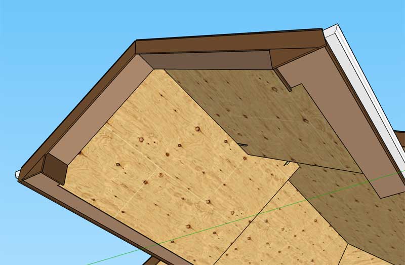

First look at a complex roof with a gable end and soffit and fascia:
I’m really trying to wrap up the soffit and fascia and get a new version released however there are a lot of details and possible geometries with the soffit and fascia when you throw gables, dutch gables and half hips into the mix. The interior gables also further complicate the matter with a number permutations that must be specifically accounted for.
I probably have at least another day of adding in more logic for all of these possibilities, but I am getting close.
