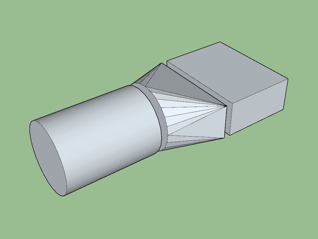

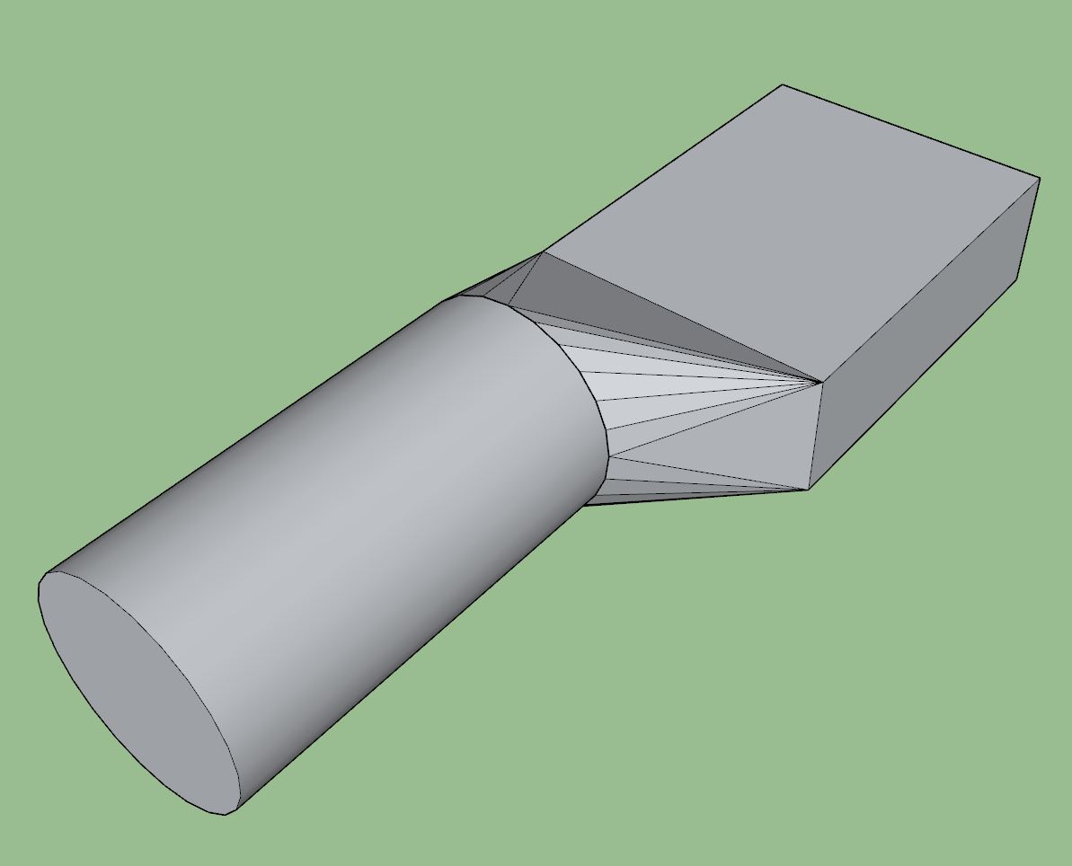

The round to rectangular transition is much less complicated than I originally thought but I still have a lot of research and study to do on this subject. The number of possible transitions and junctions is a lot more than I originally thought, this is going to be a deep rabbit hole.

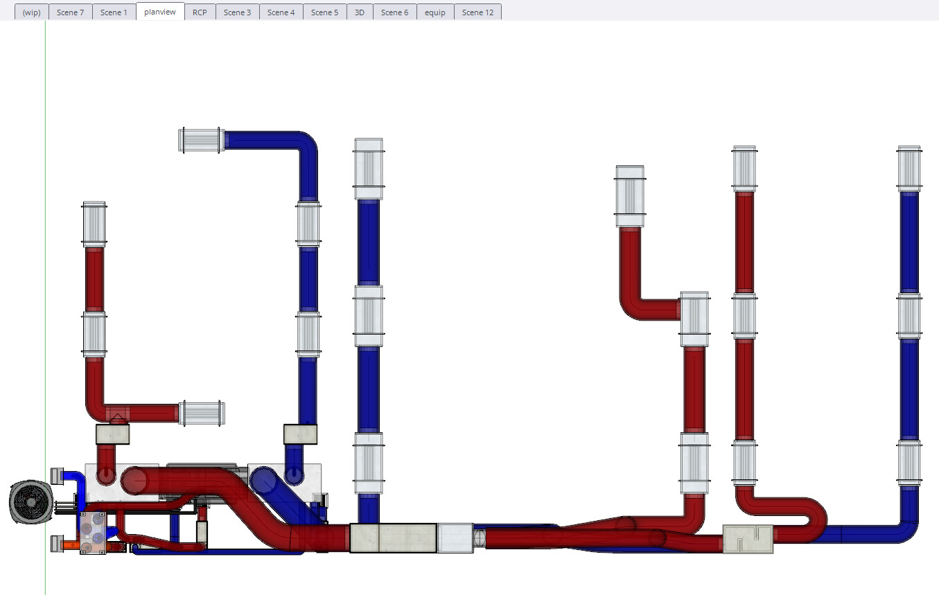

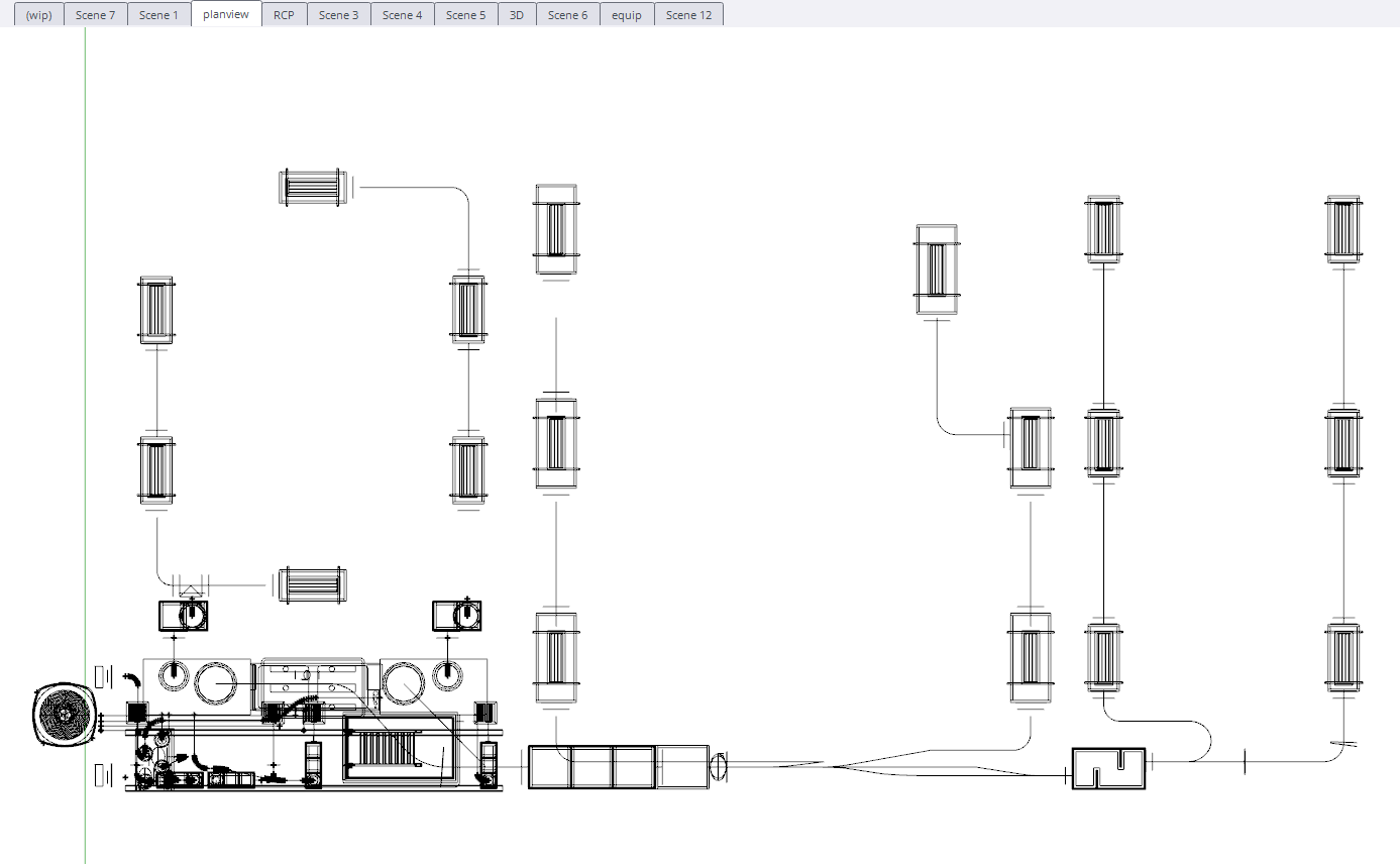

simpler is better - draw the hvac bits based on parameters provided, but skip the calculations (per Julian Smith). what would be ideal is to draw the schematic first, then place the components along way switching between views - plan and 3D - you have both formats already in place (i.e. the 3D componet contains the schematic icons much like switch symbols etc).
with my own current library and approach - i draw lines centered on what will be the ducts (my components have alignment marks), then i place components (many of which are dynamic to faciliate duct and volume sizes) and then draw the ducts to connect - either create pipeline plugin for round, or simple rectangles on a start point and then extrude or follow me.
ex. in wireframe and planview
vs thin line x-ray
After digging through some more manufacturer’s websites I’ve learned a bit more about ducting but I am still a newb. With the round to rectangle transition it can be further complicated by offsets (both X and Y). Fortunately the math involved and the modeling isn’t any more complicated, at least not at first glance.
I’m still divided about whether to pre-model a bunch of transitions, registers and vents or to simply model them on the fly with a number of pre-cooked algorithms. I find that bringing in SKP files can be a bit slower so there is the performance hit to take into consideration. I will need to give this some further thought.

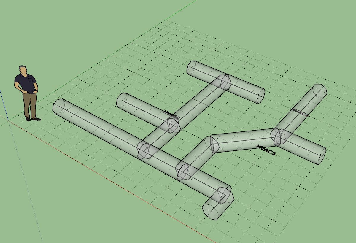

At this point I’m still testing a few proof of concept ducting ideas, I will dive into the weeds soon enough but a intuitive and easy to use ducting tool is the beginning of this plugin:
