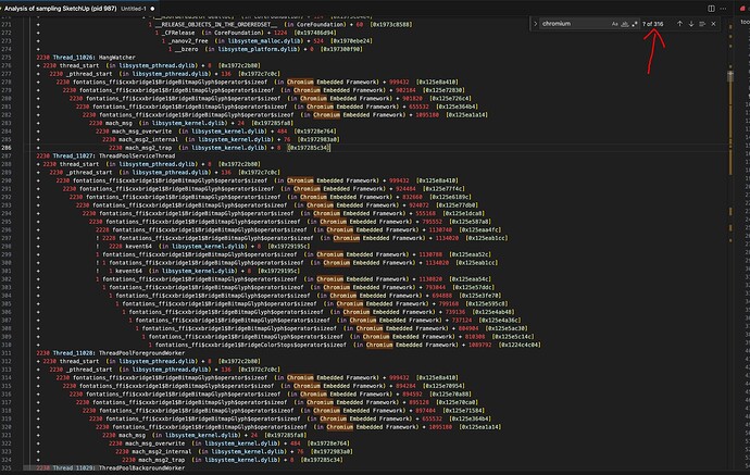

Here is my ‘process sample’ from MAC, there is a lot of lines with ‘Chromium Embedded Framework, attached full file
Analysis of sampling SketchUp (pid 987) .txt (343.8 KB)
