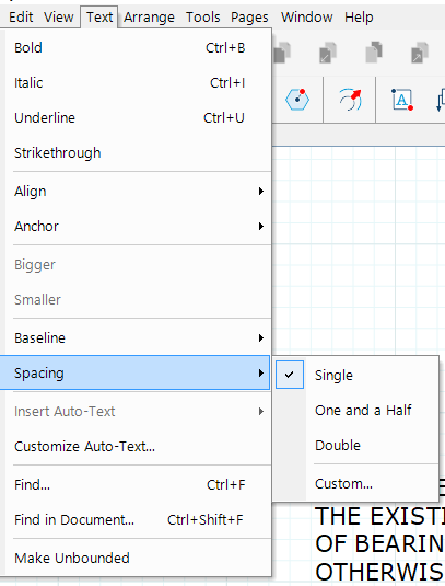

Well, before version 2024 maybe 2023 I was adding spacing before and after certain text boxes (paragraph spacing) and I never saw this issue – I’ve never used custom line spacing.
But following this post of yours I’ve discovered that this bug also affects paragraph spacing.

So I guess I’ve never seen this as I work on a Mac and cannot adjust the line spacing (unless I’m missing it somewhere…)

The spacing adjustment is only available in the pull-down menu. They omitted it from the other settings in the default tray.
No matter. My original question has been answered. There is no way to tighten the line spacing without negative consequences.

I started this thread to find out why text gets cut off. Someone answered that it is an issue with line spacing. Done.
