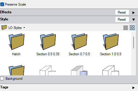

I dont understand how this works. Whenever we override styles in Layout, they show in the menu as if its been changed but they switch back to the original style…
In a temporary model I created my “override” styles in SketchUp and then saved them to a Style folder somewhere in my work folder.
In SketchUp I entered the path to the Style folder in preferences…
They then appear in Layout in the Model Tray

Here’s our scenario.
  1. In the office we have a folder on the server that has the styles that we point to.
  2. We change the style of a scene IN LAYOUT
  3. The end of the day come, we shut down our computers and come back and reopen the file in the morning.
  4. The layout shows that there was a change to the style because the menu box is grey BUT the viewport now shows no change.
We have not been able to make this workflow work for us.

This is likely due to you modifying the scene from inside layout. You should always modify the scene in SU, then update the reference in Layout. Editing the SU model and scenes from inside LO is a recipe for disaster.
We haven’t edited scenes in layout. We have only tried to update the style (and more recently tags) When the style is changed inside of layout, it causes this behavior.
I will add that we work off of a server, I don’t know if that’s important info.
Changing the SU style in LO is editing the SU scene in LO, since styles are associated with the SU scene.
Your better option is to setup SU templates that already have specific styles associated with specific scenes.
But what im understand from users like @DaveR and @PaulMcAlenan is that this is how they work. They have one simple style inside of sketchup and then in layout point to their more complex styles and change it within layout… unless I’m understanding it wrong.
I am currently doing the way you are describing, I have all of my styles inside of sketchup and my scenes are managed with each style. It’s when I try this other way suggested (that we’ve abandoned because it doesn’t work) that layout breaks for us.
I respect both of those guys and their work. However, since styles are a significant part of scenes, then modifying the style from within LO is modifying the scene. I find leaving that work inside SU is much faster since you simply resolve that aspect of the scene by simply updating the reference file which you still have to do regardless…so one step instead of two.
