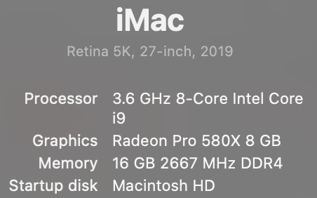

I have a memory leak problem with SU 2025 on Sequoia. It only seems to affect a limited number of people, so it may be hardware related. :thinking:
SU 2024 (24.0.598) runs quite happily on sequoia.
What hardware are you running?
With the Radeon card I’m guessing an Intel Mac?

I think you posted similar specs with a bit more memory recently…
Debating between a new top spec iMac or separate screen and equivalent Mac Mini… I don’t do 3D rendering work. This may be my penultimate purchase if I can get another six years out of the replacement.
That was my iMac machine. I put 64gb of Ram in it. Otherwise I think that is the same machine I have.
