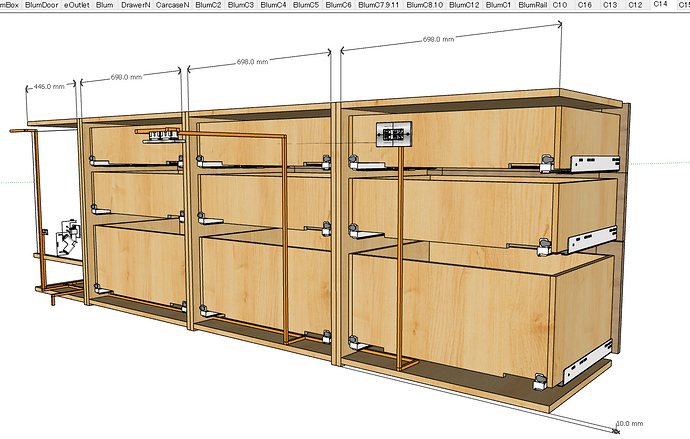

I am designing a kitchen. Kitchen has many wood boards.
If I use 1 wood board = 1 scene,
I will have ton of scene tab. It is not easy to control :rofl:
I want to use drop down menu , tree structure for scene tabs.
I need a Grouping for Scenes.
Grouping scene is useful.

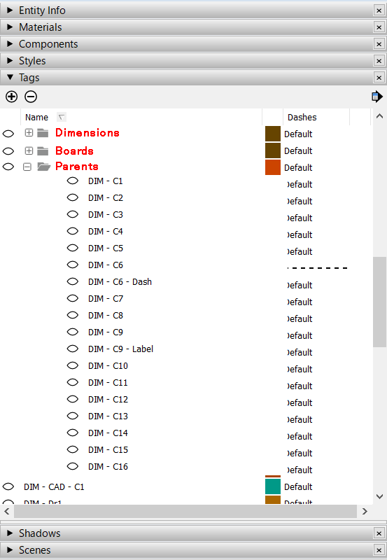

(Idea #2) Grouping tags
I also have many tags. about 100…
It is not easy to find a tag.
and Some tab should be grouped.
Grouped tag is very useful ( If SU has ).
This is useful, if we have 100 scene x 100 tags.
Please image, if we have 100 tags x 100 scenes.
ok, let’s add a new tags for a scenes. ( example Dimensions )
This new tags only used for a scene ONLY.
but I have to hide this new tag in other 99 scenes.
I have to click many times to hide added tag in other 99 scenes.
This happen many time , it’s crazy works.
if Tags has grouping, We can do this work at easy.
Just I put new tags in a group ( other 99 scene hide it ) at easy.

Why do you need a scene for each separate board? I can’t see why, myself. It is, at least, an uncommon workflow.
Each board need 2D image for output CAD file.

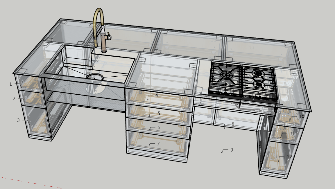

There is many drawers … it increase scenes…
There is 22 drawers. All need 2D CAD , for each board.
because Factory worker need printed CAD to cut wood board and make hole for screws…

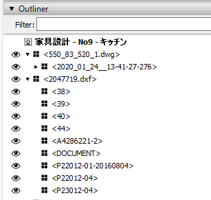

SU team, Please add grouping to Scene, Tag like Outliner grouping !

Auto Invisible Layer extension allows you to set the default for a new tag to be invisible in all existing scenes.
https://extensions.sketchup.com/extension/5fe151f4-aefe-4dcd-b37e-c0766caaa6e4/auto-invisible-layer
It works : )
but Many user use 1 tag(layer) for only 1 scene.
I hope SU application has this function in Tag dialog.

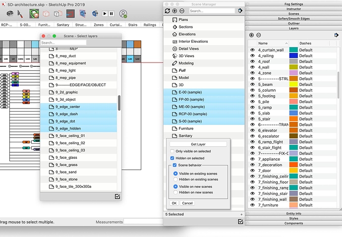

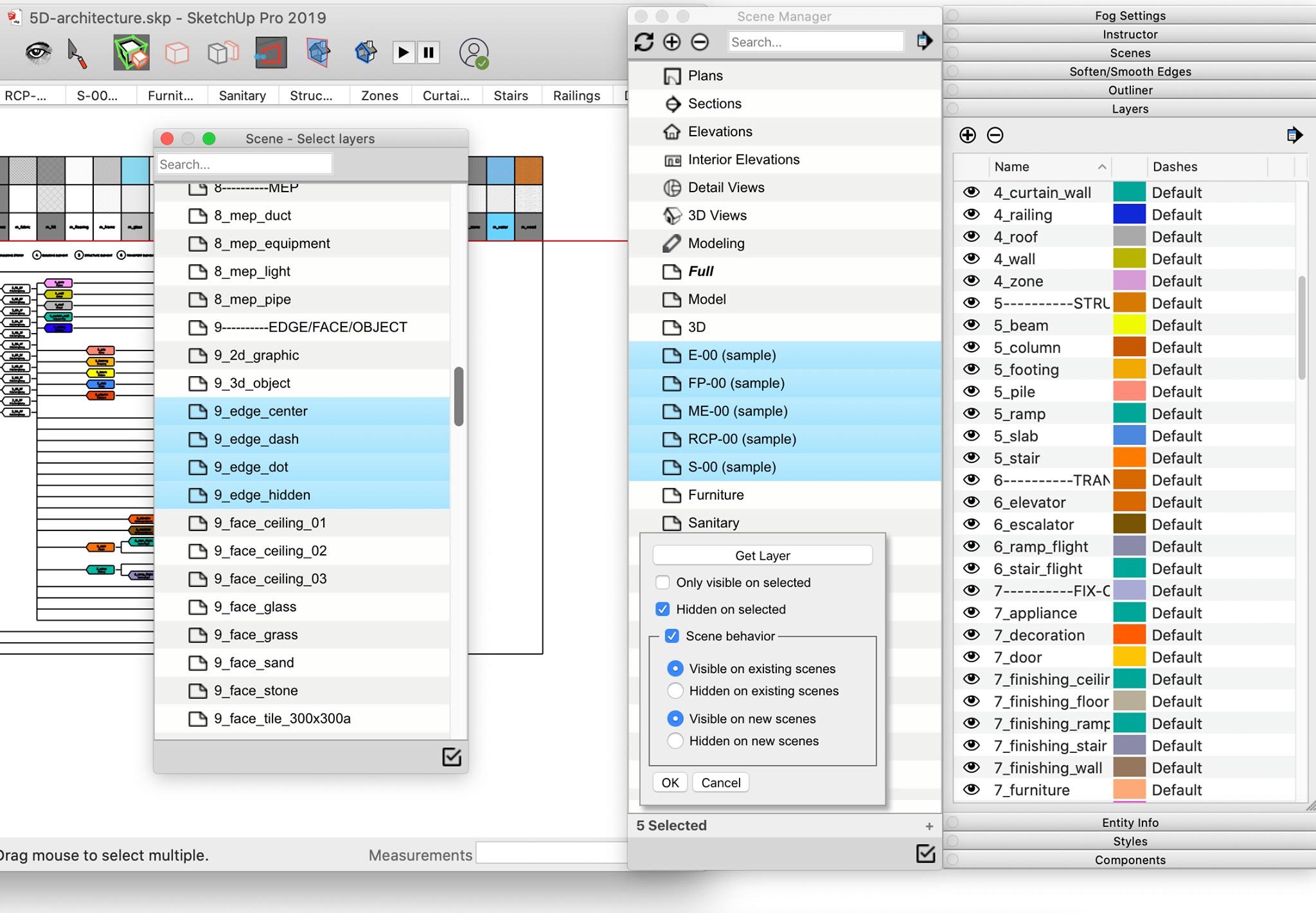

Let’s try Curic Scene Manager
It allows you to create scene groups, select one/multiple tags/layers to set display on one/multiple selected scenes/group scenes.
And also set the visibility of objects on the selected scenes
