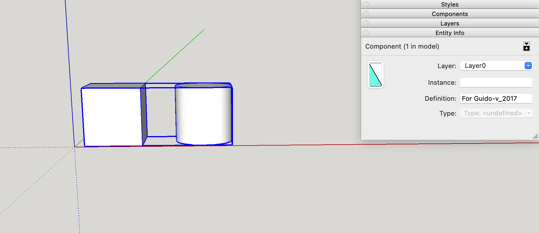

Does it come in with the cube and cylinder in a nested component called For Guido-v_2017?

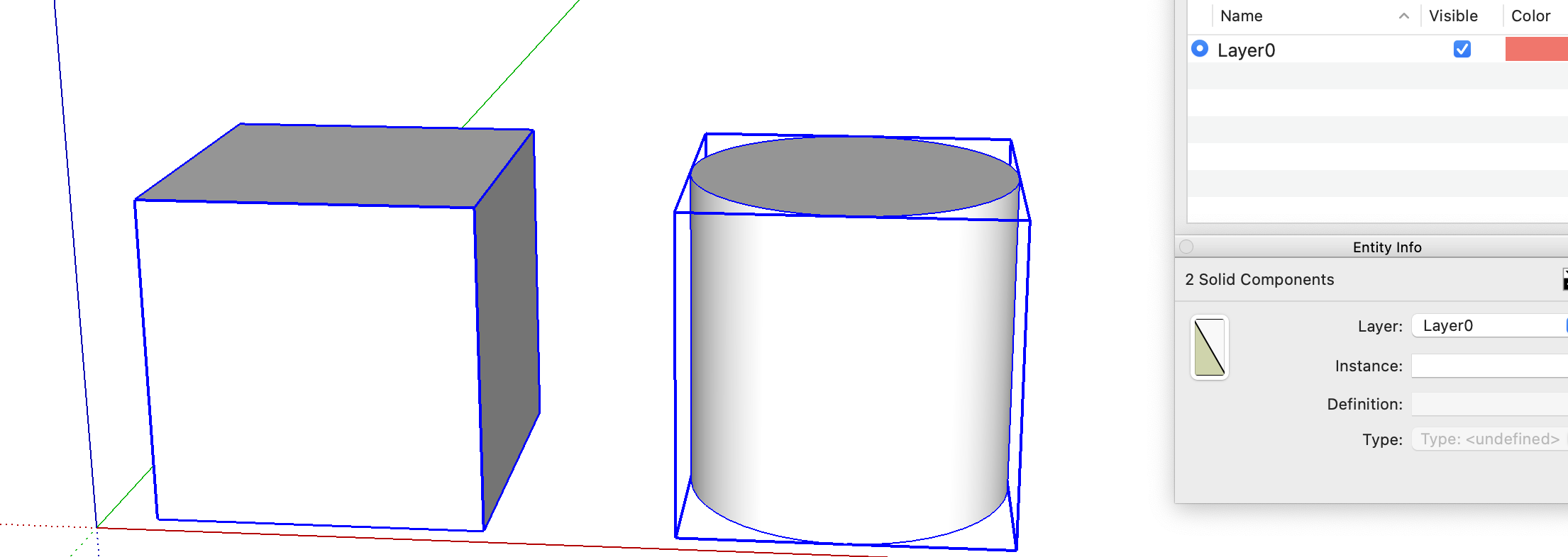

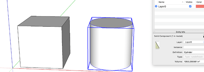

I imported it, and It comes in as 2 separate solid components, cube and cylinder, nothing nested.
That looks like you Opened the SketchUp file instead of using File>Import.
Try opening an existing model on your machine. Then use File>Import to import the file I shared.

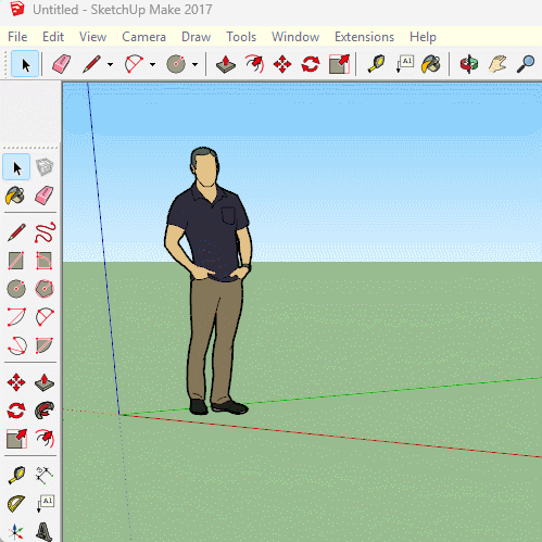

Here’s a gif for import 2017 make.
GIF 17-07-2025 11-29-13 PM
