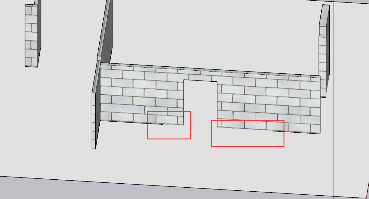

I find a bug about Sketchup::Entities#intersect_with
Sketchup Version : 2022.0.354
test.skp (1.3 MB)

model_g.entities.intersect_with(true, model_g.transformation, Sketchup.active_model.entities, IDENTITY, false, face_g)
Result
Is the following issue reported last May, the issue that you describe ?
https://github.com/SketchUp/api-issue-tracker/issues/786
I think it should not same. This is a complete face, and some of the lines in the middle are broken.And I add the situation to the issue.
The corners of the wall at the right end of the view you showed are not at the same red axis coordinate of the left end of the wall. That can lead to some issues like this.
I moved the corners into place, see if this shows less issues.
test-2.skp (1.4 MB)
