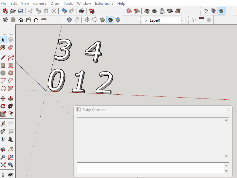

Do you want something like this?
As an example let’s assume you have 5 entities in the model…:
projecttimeline

Yes that’s what I really need.

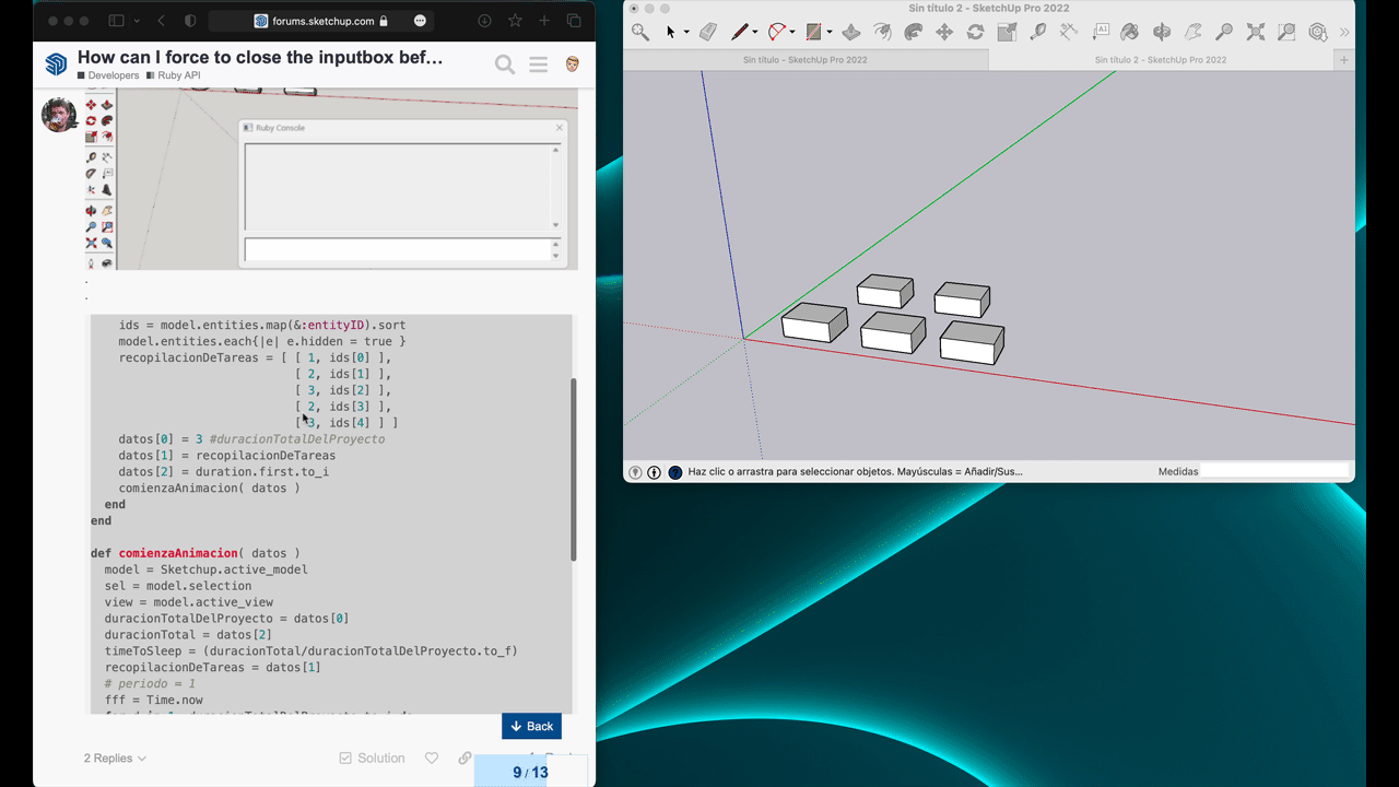

I’m afraid @dezmo that it doesn’t works on mac. I changed my code as yours and I have the same problem.
I copied your code in a new script and my input box still remain while animation.
It should be something wrong with mac.
:astonished: That is almost impossible.
If you click on any button ( OK or Cancel) of inputbox the inputbox must be closed!
If you copy-pasted my code above to your Ruby Console - you must have similar 5 (or more) entities in the model - you must see similar actions as in the .gif in my previous post.
You may have a call for user_input() or other UI.inputbox(...) somewhere else in your code…

I have only copied your code. Nothing more…
