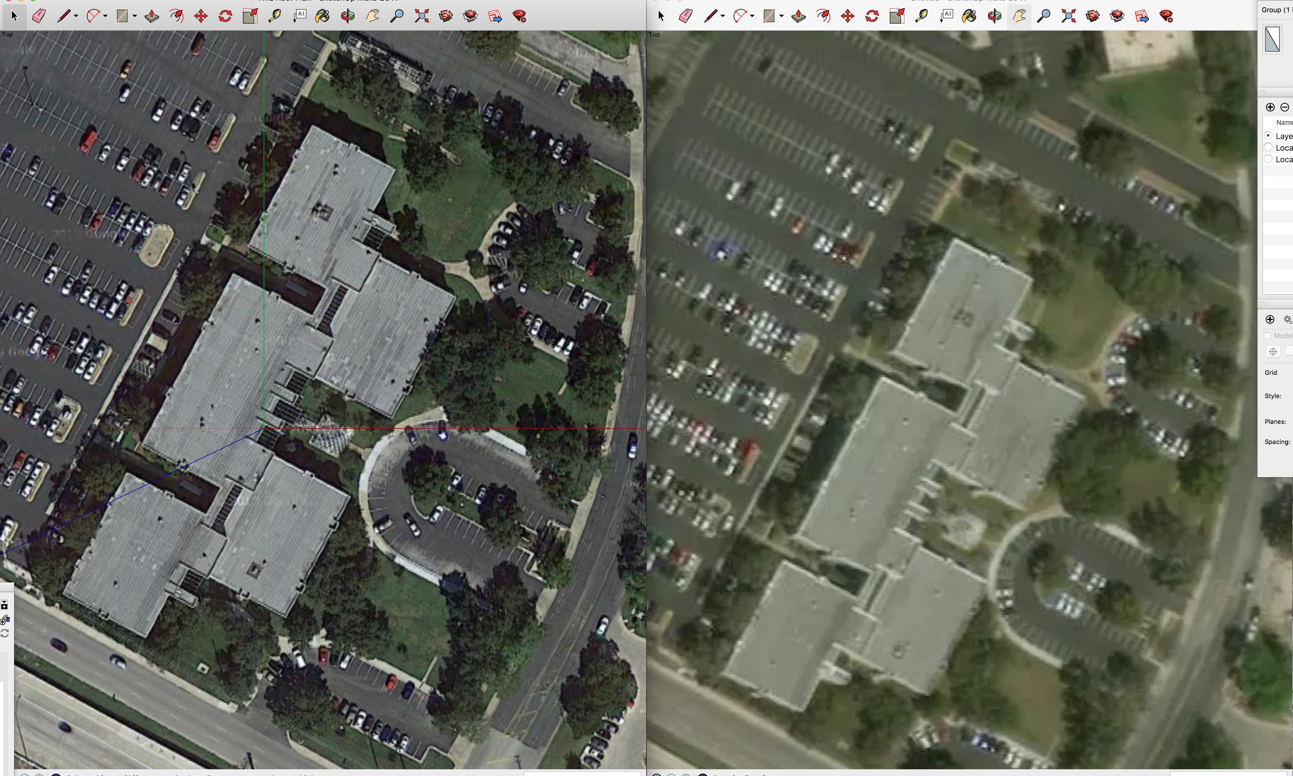

SketchUp technical support told me that SketchUp Pro will use the same piece of ■■■■ satellite imaging program as the free version. The only thing I use SketchUp for is overlaying graphic images over satellite images, so the recent change to the satellite image has rendered SketchUp COMPLETELY USELESS to me. If you know of an alternative program I would love to know what it is.
Yes, please post a screenshot of the unusable imagery? From my experience, the DigitalGlobe imagery (at the max zoom level) is very good quality and definitely usable for geo-modeling. Can you also share the specific location that you are looking at? Thanks
For instance, if I wanted to trace the outline of building, it can’t be done with the new images because they are too blurry to make out the details. Also, the image skewed and the lines aren’t at right angles to each other.

The recent change to the geo-location image quality significantly reduces the functionality of SketchUp for our office use. The image quality looks embarrassingly bad and we will cannot use it for client presentation as we previously had. The bad imagery also makes it much less functional in our design process as we cannot accurately view buildings and locations. Itdan84 accurately captures image quality issues.
As I understand it, Trimble decided not to pay for Google’s satellite image quality and has instead gone with a cheaper and significantly worse satellite imagery provider. To claim it is related to Google Earth’s API shutdown is disingenuous as Google clearly still provides other programs with their satellite imagery and up to this point had also provided SketchUp with their high quality imagery.
