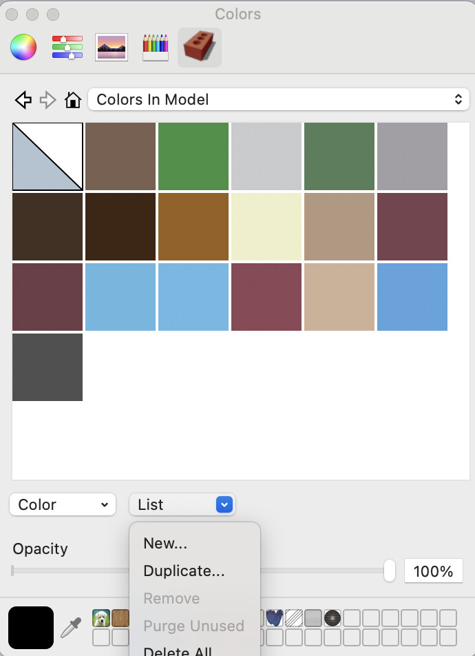

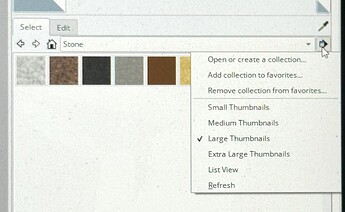

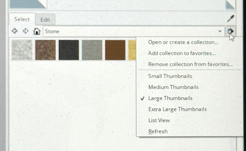

I know this thread was in 2020, but I can’t seem to find anything about this for Sketchup 2023. I’ve watched tutorials on how to purge materials in Sketchup, but it all seems to hinge on this little button that I can’t find. In the materials, it looks like image1.
image 1

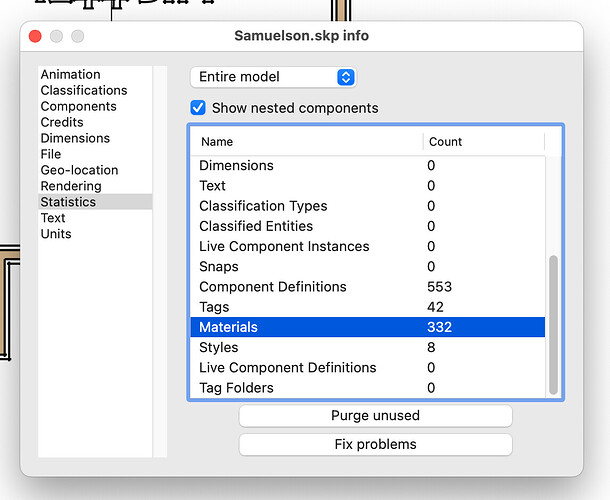

My 2023 version of sketchup doesn’t seem to have the little file/arrow button to do this (see image2). Is there a way to purge materials in sketchup 2023?
That is the difference between Windows and Mac not related to SketchUp 2023. Go to Window>Model Info>Statistics and click Purge Unused at the bottom of the window.
This is what is on that menu on Windows:

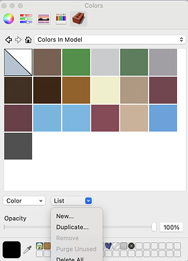

Mac doesn’t have the view options, and the collections features are referred to as lists on Mac. You can make a new list in this menu:

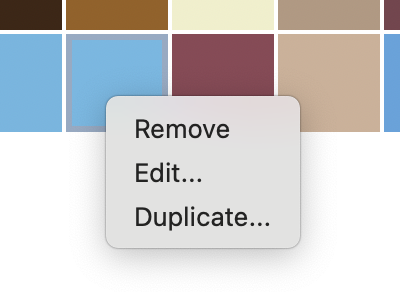

I realized after posting that I had not selected the in model colors on Windows. It does then get the features to delete all of the materials or purge the unused ones. Dave gave the right answer for how to purge materials on Mac. To delete a material on Mac you can right-click on the material in the in model set, and do these things to it:
Thank you @DaveR. I’m just gonna post a photo of your solution, because so far it’s worked the best for me. Deleting the material is fine, but that window didn’t tell me what materials are currently being used, and which are not. The “Statistics” window doesn’t either, but when you ‘Purge Unused’ it gets rid of them - I purged 120+ materials from a recent model, very helpful!
Go to Window>Model Info>Statistics and click Purge Unused near the bottom of the window.
