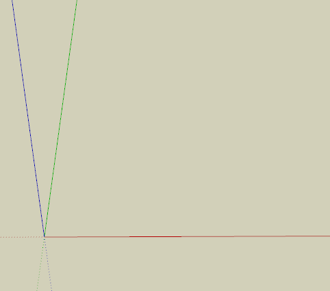

How do I draw a curve with a nominated radius?
You can do that several ways. First set Units to Meters if they aren’t already set that way. One would be to use the 2-point Arc tool and start the arc by clicking at its endpoints. Then drag out the bulge of the arc and type 12r and hit Enter.
If the units aren’t set to Meters, type 12mr and hit Enter.
And with the Pie Tool.
