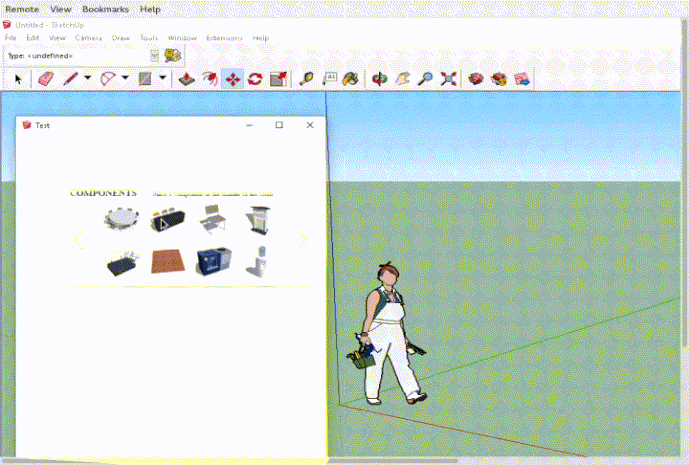

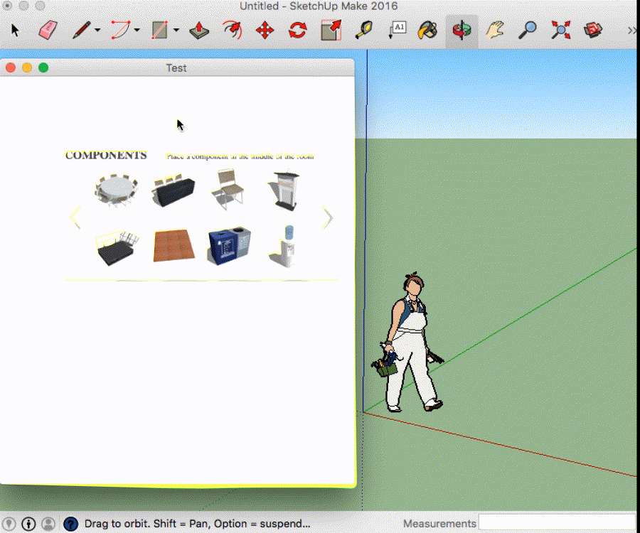

Hi guys. I’m back. Sorry again for not being available to clarify. So yes, I am creating an html page in my extension. I’m opening that page with the webdialog. In that html, I have a few anchor tags with an href using a relative path to some models I’m shipping with the extension.
On Windows, with the webdialog active, I can drag that anchor (which does happen to have a static jpg as a background-image) to the model and it will import the skp component. See animation below:
However, on Mac, the anchor gets dragged and only the text path of the href tries to drop onto the model. See animation below:

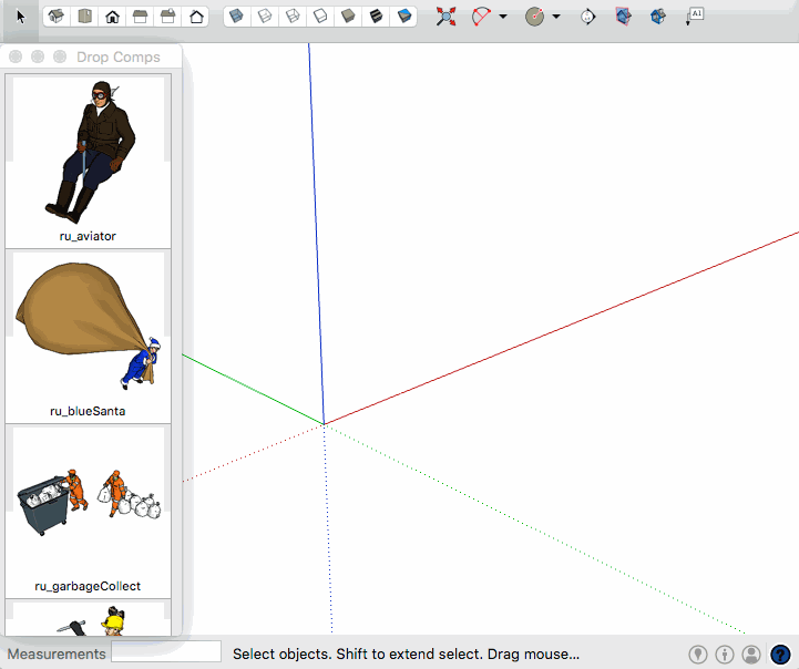

I’m still trying to get the User experience worked out, before I want to share the code openly…

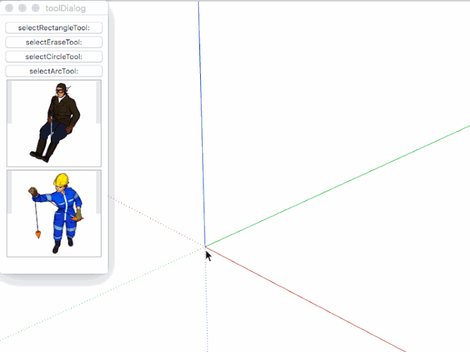

basically a button onClick event, sends an action callback to import the skp…
on a mac this ‘normally’ takes three Clicks or a Cmd Click, but varies depending on the dialogs focus…
if not Focused:
the first click focuses the dlg, the second clicks the button and the third focuses the viewport, and in this case, that would place the component blindly…
A CmdClick however will do exactly what we want and the comp will be attached to the cursor…

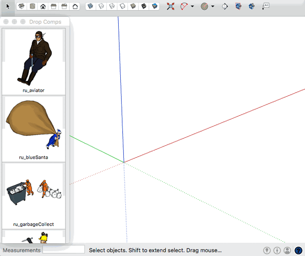

this is my latest stab at it…
the ideal for the changing of the SU cursor is to never hold focus on the dlg…
I use a combination of ‘vanilla’ javascript and ruby to manipulate the ‘focus’ between the dialog and the SU viewport…
the ‘trick’ will hinder the use of many other ‘expected’ events like tooltips, focus rings, but some may be possible by other means…
e.g. in this gif, I take advantage on osx’s ability to scroll an ‘out of focus’ window…

some of the clicks in the gifs are just me and gifs…
I PM a test script so you can evaluate what really happens…
