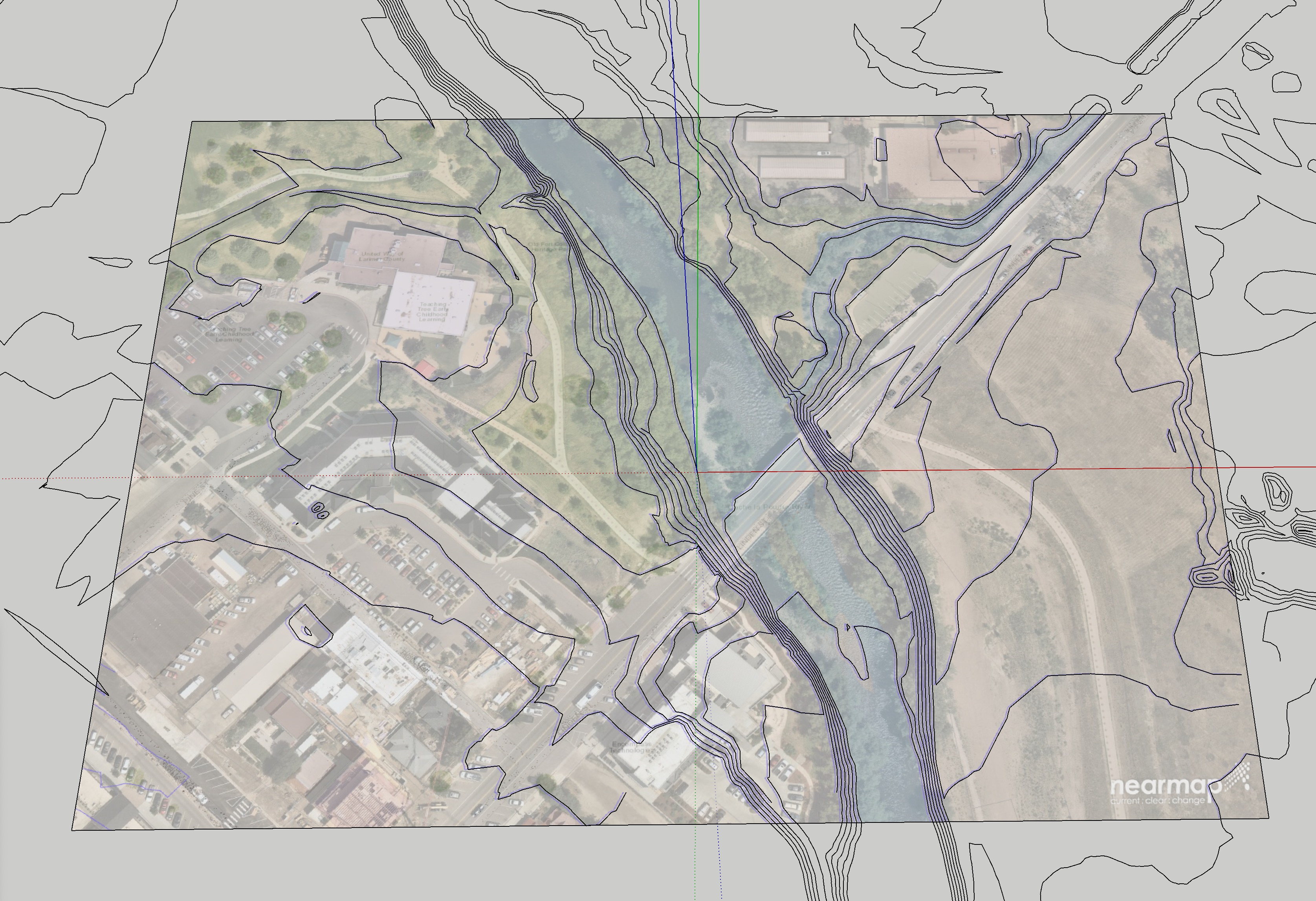

Just wanted to say thank you! This just saved me at least an hours worth of work tracing topo contours.
