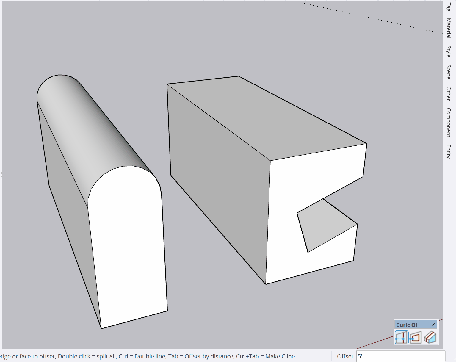

CHALKLINE TOOL - Draw single lines on single faces using reference edges or guides.
  • This tool seems to have no different functionality from preselecting objects vs no preselect.
  • Once you activate the tool, you get this tooltip:
  • The modifier keys are toggles, not holds.
    • CTRL toggles single/double line mode.
    • CTRL+TAB toggles Cline mode. This function confused me a little at first but it seems to just be a way of making tape measure guide lines without leaving the ChalkLine tool. I’m not going to go into it much further as it doesn’t seem to be any different than native and none of the YouTube videos demonstrate its use. I’m also unsure what a “Cline” is or stands for.
Cline mode:
oi 1
ChalkLine single line mode

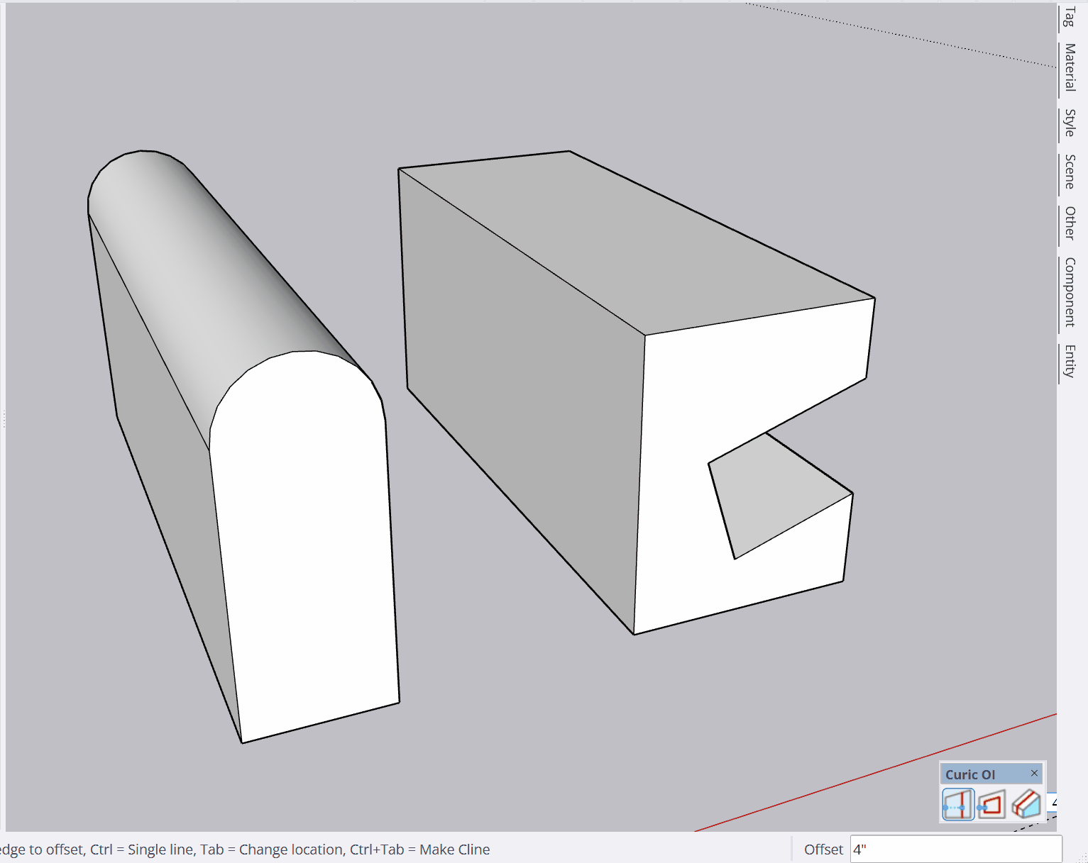

  • TAB toggles Offset by Distance mode (i.e. AutoCAD-style offset for those of you over 40 years old).
Normal vs Autocad-style
oi 12
ChalkLine double line mode
  • Slightly different tooltip when in double line mode:
  • TAB toggles Change Location mode
    • Centered - draws the double line based on a centered reference.
    • First line - draws the double line using the first line as the reference.
    • Second line - draws the double line using the second line as the reference.
Location modes
oi 123

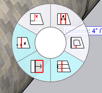

ChalkLine Right Click Pie Menu
  • Double line distance (12 o’clock) - opens a dialog that allows setting the distance between double lines when using double line mode. You can also VCB input this distance prior to using the tool as long as double line mode is active when you do it.
  • One segment (2 o’clock) - this is a toggle that allows creating subdivisions that don’t intersect across the entire face.
  • Multi faces (4 o’clock) - this is the opposite toggle. By default, ChalkLine is in this mode.
I’m not sure why Curic chose to use two separate buttons for this and one segment instead of just a toggle. Also kind of wish that he used the ALT key as a modifier for this toggle instead of right click, hunt for a button, then left click.
One segment vs Multi faces
oi 1234
  • Push line (6 o’clock) - this toggle allows “push/pulling” a single line into a 2D face away from the existing face. It’s an interesting tool and I’d love to hear some use cases for it because I don’t currently know of many.
Push line mode
oi 12345
  • Show opposite distance (8 o’clock) - this toggles the red SnapDim. By default, ChalkLine is in this mode. I see no reason why this should ever be turned off.
  • Erase edge and auto fix vertex (10 o’clock) - you have to be hovering over an edge for this to do anything. It deletes the edge highlighted by the cursor and welds any points where it was splitting the boundary of the face. I think? I never use this.

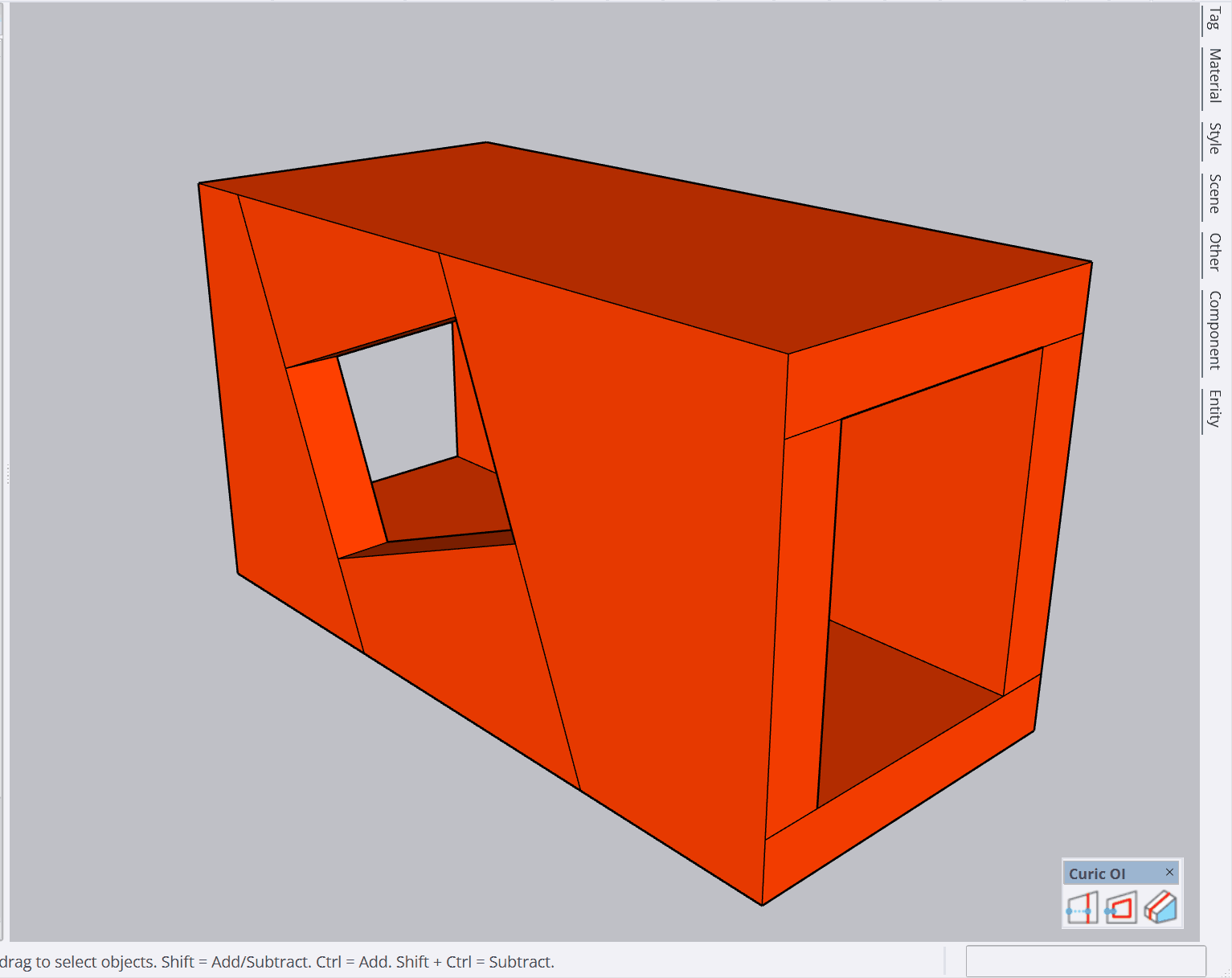

After the initial click to start ChalkLine, there are some new options:
  • Use the mouse cursor and inferences to locate the offset line. During this step you can choose which face to to draw the lines on. It does not have to be the face that the operation was started on. This is really where the power of Curic OI resides.
Drawing ChalkLines on different groups
oi 123456
  • Holding SHIFT locks the inference to a given face. This function is not indicated in any tooltip. It’s very helpful for fine tuning and working in complex models.
Using shift to isolate faces. This allows using other faces to inference without being forced to draw on them by the tool
oi 1234567
  • SnapDims (explained in DIO documentation thread.) are available to set the distance of the offset.
  • VCB inputting the offset distance will draw the single or double line at that distance, ending the tool. Note that either SnapDim can be input. By default, it sets the Blue measurement, but the Red can be set instead by preceding the VCB input with a comma.
VCB input of red SnapDim
oi 12345678
  • LEFT CLICK and DRAG enters rotate mode, allowing the creation of angled single and double lines. At the release of the click, the line is drawn. VCB input at this point for precise angles.
Important note here: VCB input to set the angle only works in single line mode. You can rotate a double offset line, but you’re hemmed in by the angle set when you let go of click drag. Due to a bug, it thinks you’re VCB inputting the line spacing for double line. I would advise always using single line mode to make angled ChalkLines.
ChalkLine Rotate and VCB
oi 123456789

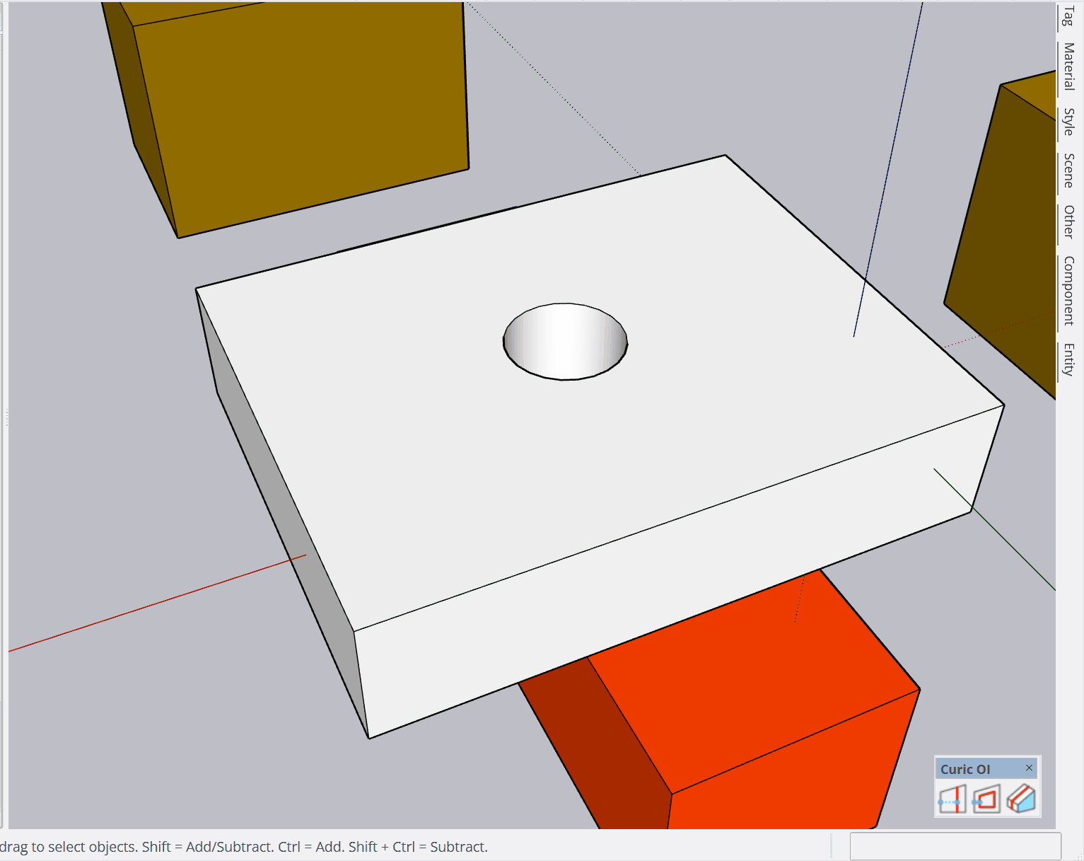

OFFSET TOOL - Draw offset boundaries on faces
  • Initial tooltip:
  • Offset doesn’t care about preselects.

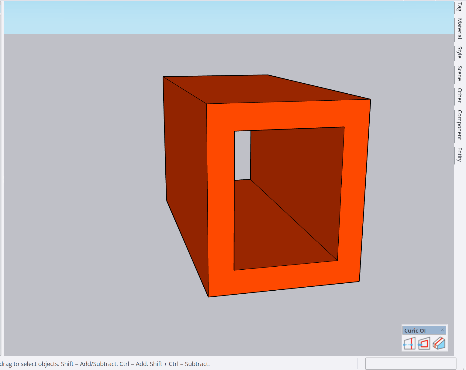

  • Not as many options here. You can click on a face to create an offset boundary of that face. The UI of the tool highlights the face that is under the mouse cursor.
  • TAB toggles Inside face mode. This is somewhat confusing because the UI is not clear on which mode is which. On one toggle setting, you will see the offset line in the UI indicated as dashed when it’s outside the face. If you try to offset the line outside the boundary, nothing happens during this mode unless your mouse is over different coplanar face (yes, it’s confusing). If the tool is in the opposite toggle state, it allows creating a 2D face outside of the reference face like native offset. In this state, Offset can only draw inside of the selected object (yes, again, it’s confusing).
TutorialsUp video at 6:20 tries to demonstrate the two modes but I think it misses some of the nuances.
Toggling Normal mode vs Inside face mode, then drawing in normal mode
oi 98
Interior offset in Inside face mode, then normal mode
oi 9876
Offset onto separate object’s coplanar face with each mode setting: Note that in the first part, the new face is part of the right side object’s geometry, while in the second part, the new lines are part of the left object’s geometry.
oi 9876

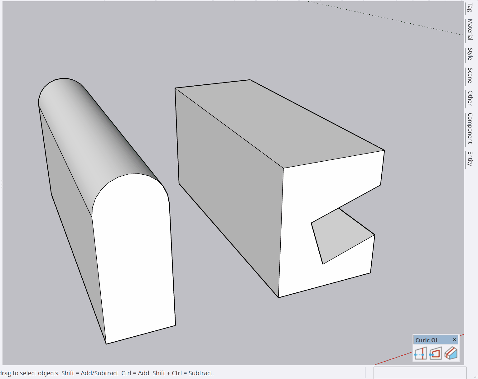

It’s important to understand that unlike the ChalkLine tool, the Offset tool requires coplanarity in order to transfer offset lines to other solids. This in my view makes Offset far less powerful and more niche than ChalkLine.
Can’t offset to non-coplanar face
oi 98765
Offset requires picking a face, but the edge that it uses to measure also has an effect on which boundary gets offset, and onto which object it can transfer lines. You can see which edge is being referenced as a blue dot in the UI.
Inside boundary vs outside boundary
oi 987654
We can only transfer offsets along the line perpendicular to the edge of the face selected for offset
oi 9876543
  • Offset also has fewer options in it’s right click context menu. No pie menu this time, just the ability to change the LengthSnapping and UI Scale. This is also true of Intersect.

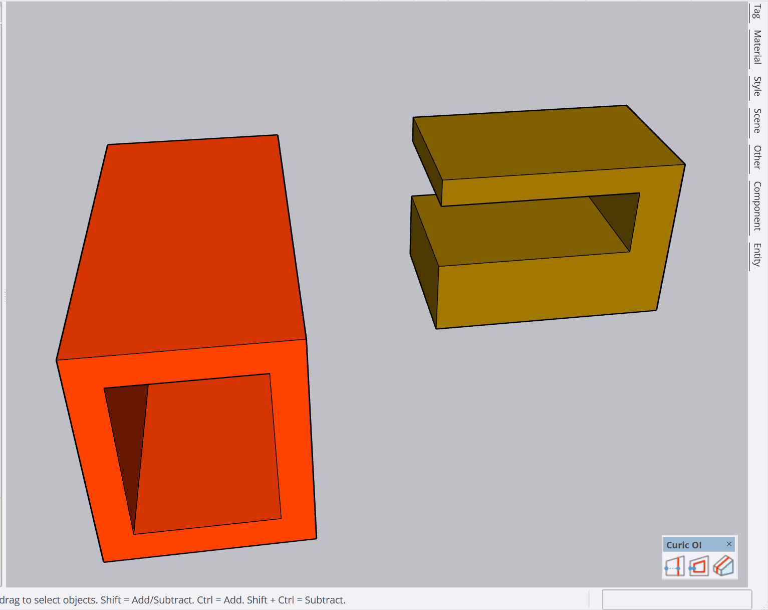

INTERSECT TOOL - Draw lines on solids using reference faces.
  • Initial tooltip:
  • Intersect doesn’t care about preselects.
  • Like Offset, Intersect requires you to select a face. Unlike offset, it does not care about any edge on that picked face. Instead of measuring to the edge of that face, it measures perpendicularly from that face.
  • There are no modifiers at this point. All it wants is for you to left click on a face.
After the face is selected:
  • The picked face is shown in magenta and the slice preview is shown in red. By default, it wants to operate on the initial object.
  • Intersect uses a similar “get object” functionality like the DIO tools. Once you click a face, it selects the solid that the face is a part of, showing a green dashed outline of it. Holding CTRL and left clicking during the Intersect operation allows selecting another object in the model. In this mode, it allows you to create a boundary line on that object using the current face as a reference.
  • Like offset, there is one blue SnapDim shown here. It can only be in the two possible perpendicular directions from the picked face.
  • At this point, either VCB input to enter a distance or use native inferences and left click to choose the offset distance.
“Vanilla” Intersect
oi 987654321
Intersect using “get object”
oi 9876543210
After using Intersect:
  • VCB input to change the distance of the last intersect (like native tools).
  • Intersect fully supports multiply and divide array copies.
VCB input and multiply Intersect
oi 99
Inference input and divide Intersect
oi 998
The tooltip says there’s an option to “Double click = split all.” I tested this on many different objects and couldn’t get it to do anything. I’m sure that I’m missing something. Help?
It’s important to note that Intersect always maintains the integrity of solids. It is not creating interior faces, only lines on the outside of the solid being operated on.
I like to think of Intersect as ChalkLine’s developmentally disabled older brother. It sorta does what ChalkLine does but with planes instead of edges and without as much finesse or capability. It’s strength is in its ability to generate more geometry in one operation. It’s also a hell of a lot simpler to use.
