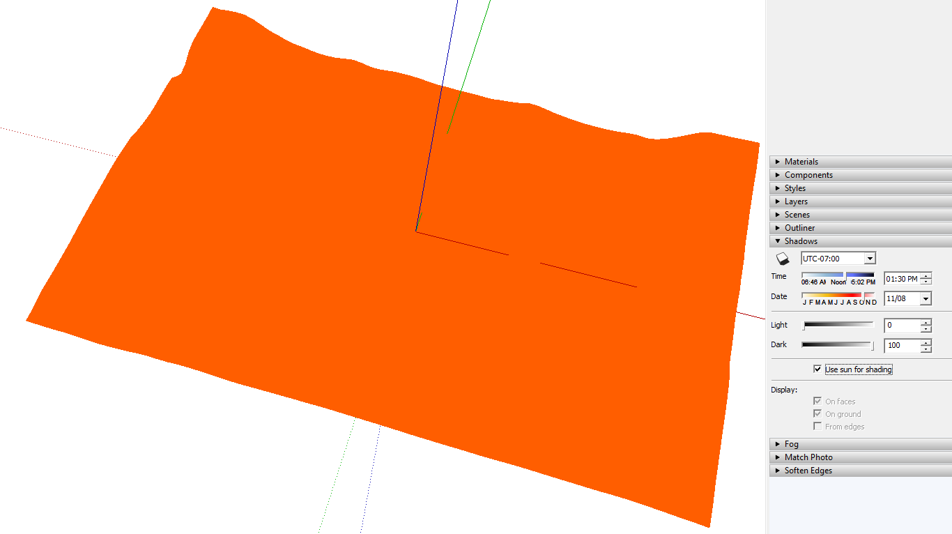

The below image is a mountainous terrain. As you can see, there are splotchy areas of colour where in fact, the whole surface is the same colour. Is there a way to turn off those splotches? It’s affecting my export for CLF Color by Z plugin. Instead of the mountain peak being the darkest, just south of the peak is darkest because of these weird shadow areas.
Shadows are off and ‘Use sun for shading’ is off. Looks the same whether it’s shaded with materials or shaded without materials.
Anyone have any idea to solve this issue?
To get rid of all the shading, turn Use Sun for Shading ON, set the Light slider all the way to the left and the dark slider all the way to the right.
