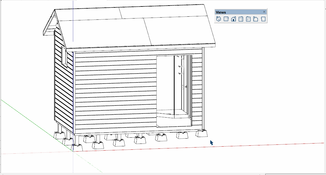

Zoom extents does work to get the desired view back. However it would be nice if we could create the one scene in parallel projection, front view, for example, and then just change the camera standard view function to see the front, left, right views as needed without it zooming way out of view and then having to find where it is - thereby only needing to create one scene for that particular piece of geometry (like the kitchen portion of the entire model in this screen recording)
This works for me. I use it regularly for creating elevation scenes in SketchUp.
