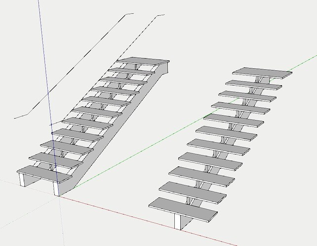

I used the Stair Tool in 1001 Bit Pro to make one close to it and then just edited it as needed.
The original one on the left and modified one on the right. Still need the railings but as Dave said Profile Builder might get you that part.
