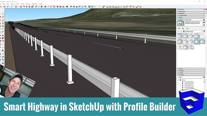

While it’s a little cumbersome, this tutorial outlines a technique that maybe is more than you need, but shows a combination of approaches to create a highway on a terrain.
