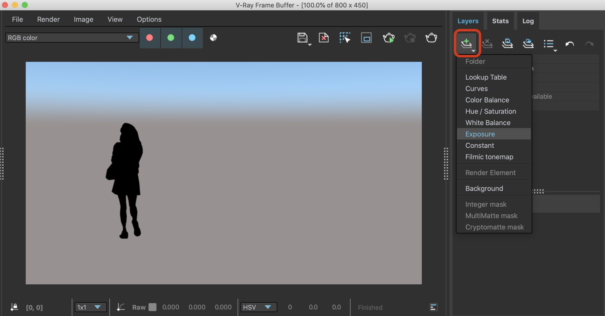

The lights do look better, so thank you! But I have one more (hopefully just one) question- @eric-s talked about highlight burn. I have it turned down to the minimum in Vray buffer frame. I found another “highlight burn” in vray settings, I lowered it but hmm… didn’t change that much. Which highlight burn did you mean? :wink:
You can find it in the Frame Buffer. You need to add an ‘Exposure Layer’ in the Frame Buffer…then you can adjust the Highlight Burn.
Mhm, yup, I changed that one :wink: I think I’ll try resetting the vray settings cause I read that it can help with lots of different problems :wink: thanks again :slight_smile:
