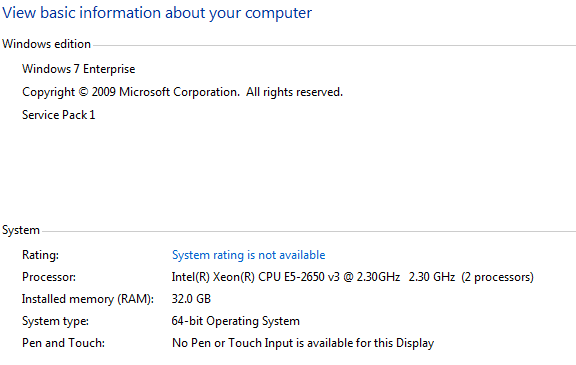

Hmm… that didn’t crash when I tested it. What computer system do you have? OS version etc?
SUModelFixErrors will have some overhead, yes.
computer_info
Windows 10 x64, SDK 18.0.16975.0 + Sketchup 2018 PRO
