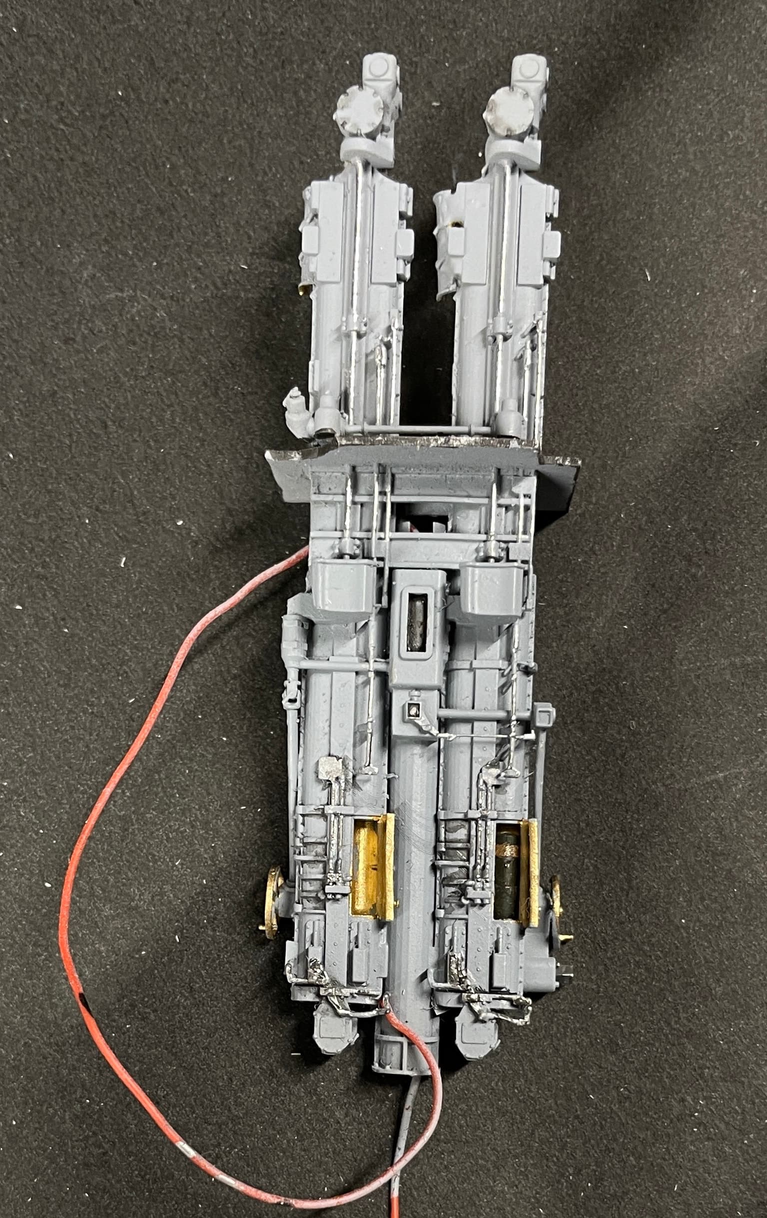

Sometimes the smallest details take the most work and aggravation. The pointer’s seat was one of those things. It broke so many times trying to fit it that I replace the support with some phos-bronze wire. I replaced the seat itself twice using spares, but the support gave out at last until I replaced it.
Didn’t have as much trouble with the trainer’s position. I got its seat in place without damage.
I then installed the right hand gun. The trunnion caps were being very finicky. Should have used a larger gauge wire when I did that part. If they don’t hold I’ll redo them with the larger size.
So here’s all that’s left in outfitting the gun house.

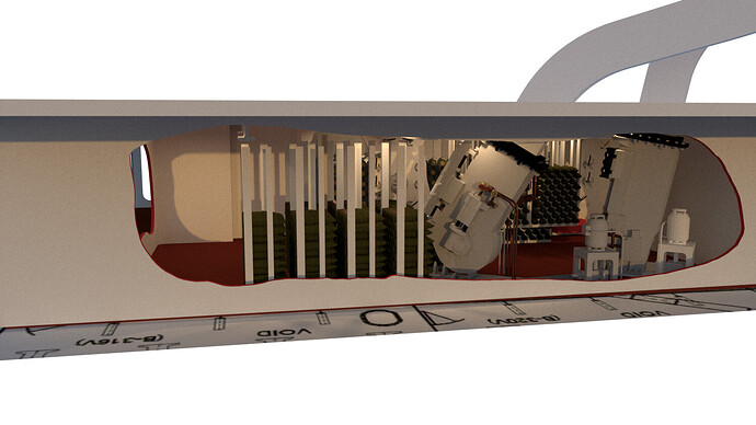

There’s only one 3D print left to do after today’s work. All the rest are drawn and in the printer or waiting in the queue. These panels were the last parts of the magazine I needed to design and print. I still have to deign and print something resembling a porthole for the little bit of exterior superstructure that I’m including in the model.
Here are the panels in the lower handling room of the magazine.
Here’s the SU drawing:
I simplified the cabling and made the wall mounts more robust for the sake of printing and asssembly.
And here it is in color.
And lastly, here they are on the slicer. I only need one set, but I ALWAYS print more. The printer doesn’t care.
Still don’t know what I’m going to do about that ceiling. It may mean more printing. The question is how can you view it? Unless you’re a little kid looking up or an adult on your knees, it will be very hard to visuallize. Here’s another shot of the ceiling showing the cooling coils that are all over the place.
