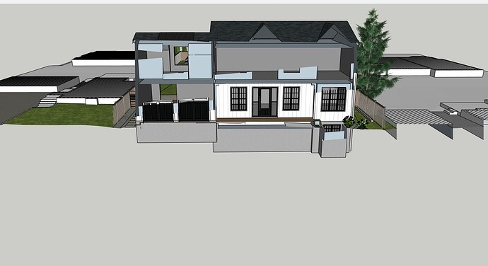

HI everyone. I am having issues while moving and viewing my model. At first it was only slightly annoying. But as I now need to show clients some revisions before I it again. I recently updated to Sketchup 2024. Depending on the angle of the view point the model cuts away (test 1.3). Not Cool. If the view point is ok (test1.1) and I turn shadows on. It automatically cuts the the model away. (test 1)
Is this unique to Sketchup 2024? Is this just a simple setting adjustment. I have been using Sketchup since 2008. So I am not a rookie but i feel i always have more to learn.

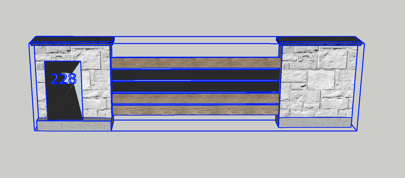

The problem is that one of these has somehow gotten placed an immense distance from the model proper:
Edit: I forgot to tell how to fix it! Select the proper contents of the model, do Edit->Invert Selection, and then delete. The model will then cease clipping.
