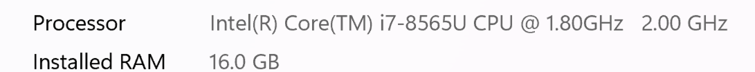

That is moderately large. How long is a “really long time?” How much CPU and memory are the SketchUp process consuming?
I only have windows explorer, task manager, discord, and sketchup running. By really long time I mean it still hasn’t loaded. its been about an hour.
Where did you set the fine-coarse adjustable slider for SimLab Importer? All the way fine? This can take significantly longer. I have had imports that took over an hour, these became over 250mb in SketchUp and almost unusable. Start with the lowest quality and work your way up until you have what you need. If you really need to work the file afterward consider running clean up 3 to merge coplanar faces, which there are likely to be thousands of with the .stp to .skp import, this can also take a long time but yields a much more workable file.
That is fairly long, I agree.
