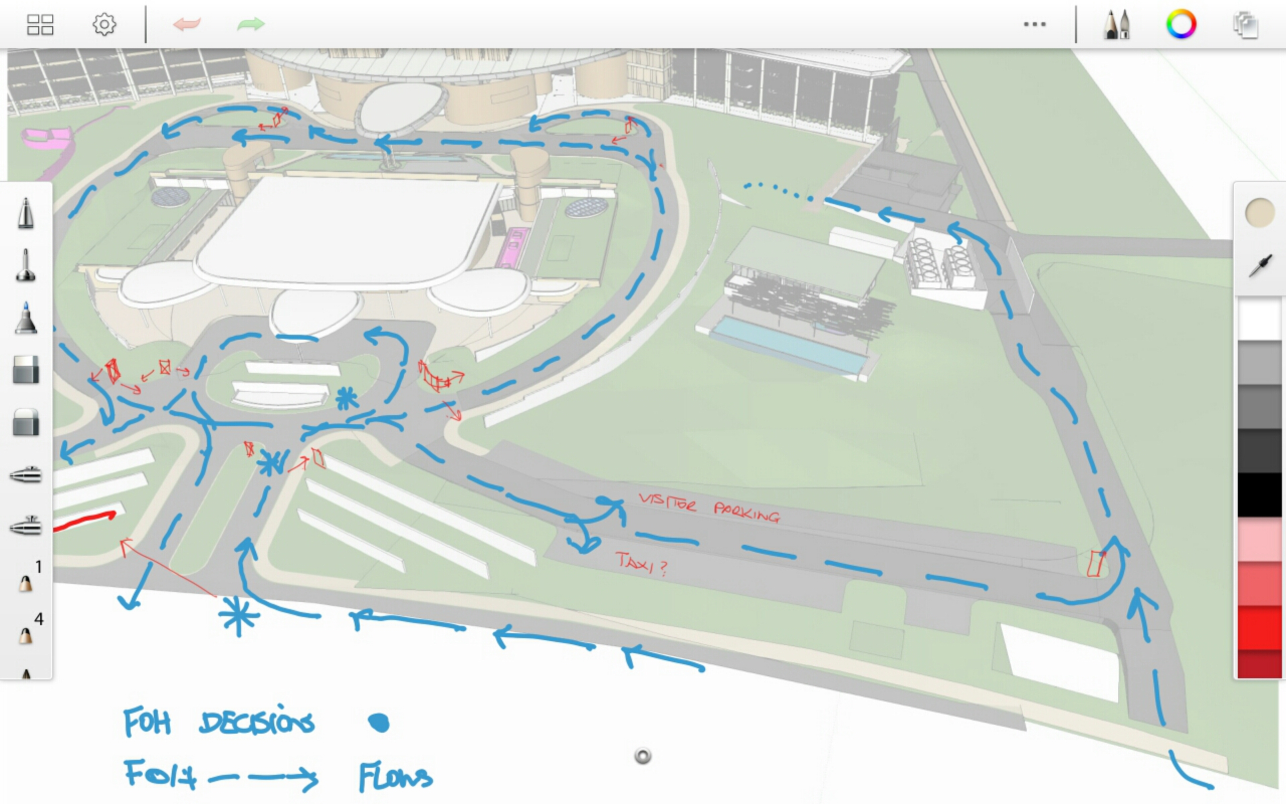

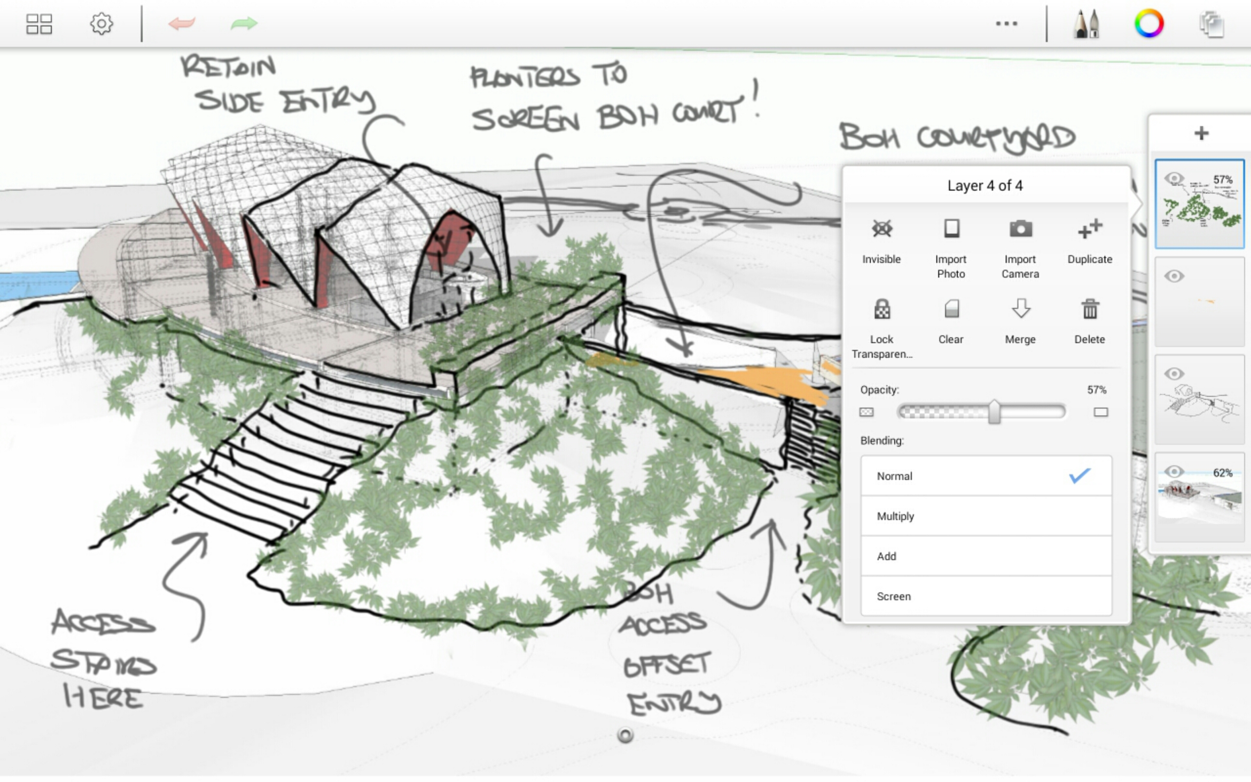

I have a Samsung Galaxy Note 12.2 that is absolutely brilliant for my architectural work -
I seriously don’t have any paper in my office and
quite frankly any architect worth their salt should have one of these or [cough Ipad Pro].
I have Sketchup Viewer on it [Android] and also have tried My.Sketchup
both work fine for smaller models and are very easy to use with a pen.
Nevertheless, all my core work is really done on my notebook…
The samsung comes into play with sketching -
I [ r my staff ] simply screen capture a Sketchup view…
copy it to Gdrive or email it to myself
Open it on my Samsung with Sketchbook [came free with the Samsung] and
sketch overlay new ideas… test alternative layouts etc etc…
even markup consultants autocad drawings [there are free apps for opening them on an android]
PS - I am a great fan of the Android ecosystem [ not W10]
so cheap,
so flexible,
so stable,
apps interchange data so easily
And amazing apps [slab design, structural design, on and on]
anyway some screen shots to give you some ideas of sketchup + sketchbook
If you have never tried a Pen Tablet [Wacom] just do it…
I have not printed a piece of paper in 3 years
These are really great. I ve a samsung tab S3 and and was trying my hand on web.sketchup.com. unfortunately this is not working on my tab web browser. do I need to change some setting to work on my browser? pls do advise. thnx.
just to be clear, I am not running SU on my Samsung,
I am sketching over SU screen captures from my PC
using the SKETCHBOOK app on the Samsung …
transferring images between the two by emailing myself or
my recently using Google Photos
