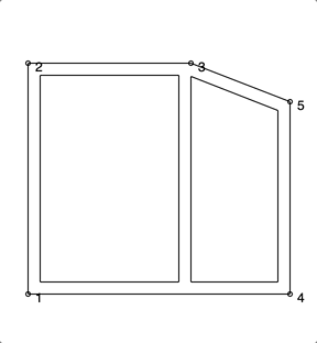

Yes, I now have expertise in parametric. In last weeks, I have created a code that manages parametric relationships, here is an example of its use. Compared to Dynamic Components, I manage angles more easily (very easily !). And above all, I master the code and decide on its development without waiting more than 10 years. :popcorn:
