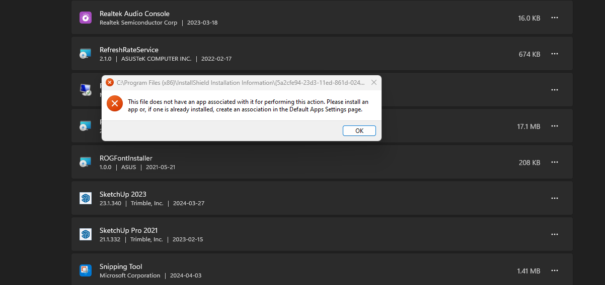

I’m trying to uninstall Sketchup Pro 2023 on Windows 11 from my computer and this appears every time I click on “uninstall” in the apps settings.
Do not uninstall this way.
Instead use the SketchUp installer executable, (right-click it, use “Run as administrator”) and choose the Uninstall option.
