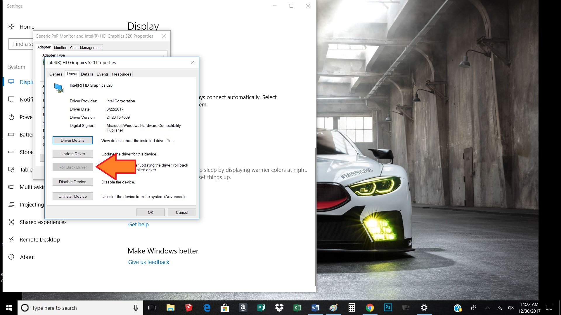

I am happy to say that this problem is now fixed on SketchUp Pro 2018. I found how to roll back the most recent graphics card driver update and the select tool lag instantly went away.

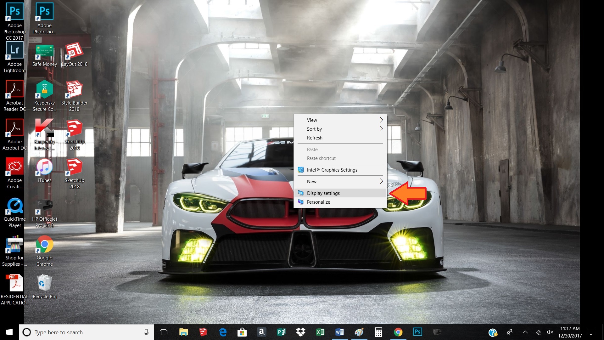

In my opinion, Windows 10 is organized in a very illogical way, so just finding out how to determine which graphics card is actually on my laptop was a challenge. But, I did manage to revert to an older version of my graphics driver and this was an instant fix (I did also install the script provided at the top of this thread). These are the steps…
Right click your desktop and choose display settings (note orange arrow).
Windows will show display options - click Display adapter properties
Click the Properties button
Select the Drivers tab
Click Roll Back Driver (in this instance, my computer shows this option greyed out).
Rolling back the driver instantly fixed the problem.
I am told windows will reinstall the latest driver at the next update and the problem can return.
That seems to be true from reading through the reports in which the problem was sorted by graphics driver rollback and then the problem appears again a few weeks later.
