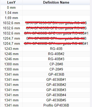

Hi! im struggling with report, when i make it, it doesnt count the components that are the same and have the same lenght, because it renames them with #1, #2…and so
Senza titolo
i dont know what am i doing wrong
I think what you are doing:
(Copies the original componentinstance and adjusts its size in each instance >> wich causing the instance to be forced to “Make Unique” )
whatyoudo
What I think you should do:
Adjust the size of the original componentinstance, then copy.
needtodo
Got it, but what happens with the files and projects i have already made? can this be solved in excel?
It is possible to make and run a custom macro (VBA) to clean up the excel file. Remove all #nums , then sum and present as required
this may go, but i have no idea how to do it, do you know any tutorial? thanks
