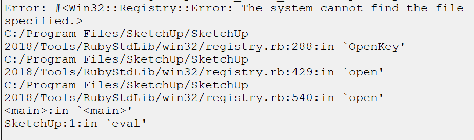

Can anyone tell me what is wrong with this method? I’ve been using this to generate a machine ID, and it was working fine for a long time. Now I have a customer with a windows 7 64 machine and gives and error. I don’t have the exact error but something about a sketchup/tools/win32/registry.rb not found.
Does anyone have a windows 7 machine to test this on?

The "win32" folder is at this path (the first in the $LOAD_PATH array): "C:/Program Files/SketchUp/SketchUp 20nn/Tools/RubyStdLib"
(where nn is the major version number.)
However, the standard library was only distributed with SketchUp 2014 and higher.
I do not get any error running require 'win32/registry' at the console, and afterward Win32 is accessible. (if defined?(Win32) would be the simplest test post require to see that the library was loaded.)
