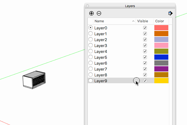

I have a database of information stored about each layer, and that database needs to update automatically whenever the user changes the layer names. If I can get the old value for the layer name, it’s a little bit more direct to modify the database rather than store the list of layers separately and find the missing name as john explained.
layers
it does not catch new generic layers e.g. Layer1, Layer2, etc…
that’s why I have onLayerAdded(layers, layer) as well…
john
Ah you’re right. I also noticed that onLayerAdded will fire twice when adding a layer, once when clicking (+) and once when renaming the layer.
