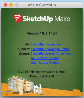

Again, I’m using this version of SketchUp:
