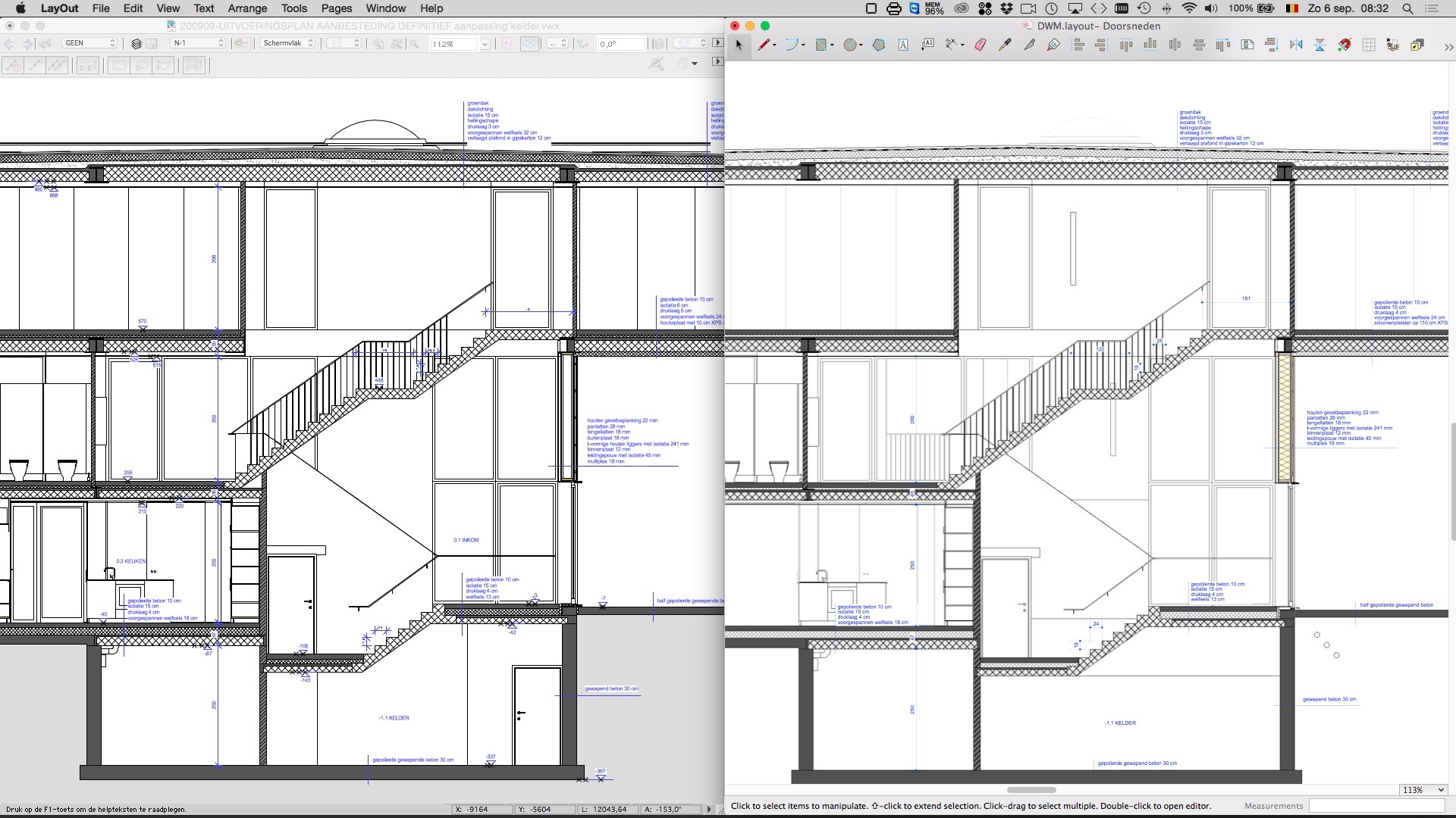

Yes it’s possible to use LayOut as an AutoCad or Revit replacement. I self switched from Vectorworks to only SketchUp with LayOut three years ago. To make the switch easier we made the extension Skalp for SketchUp to generate automatically hatchings of your section cuts.
Here is an example of the same drawing in Vectorworks and in LayOut:

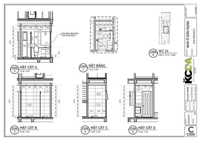

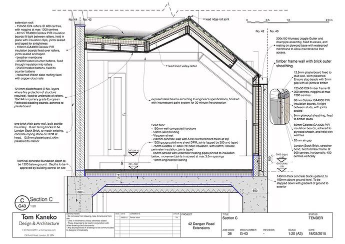

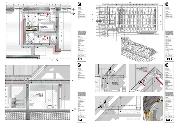

I think the best detailed answer is to take a look at the results. Here are some examples of users of Skalp for SketchUp who also only use SketchUp and LayOut:

Line weights are at this moment one the the weak points, but in our upcoming Skalp 1.5 release all sectioned objects can have there own lineweight.
