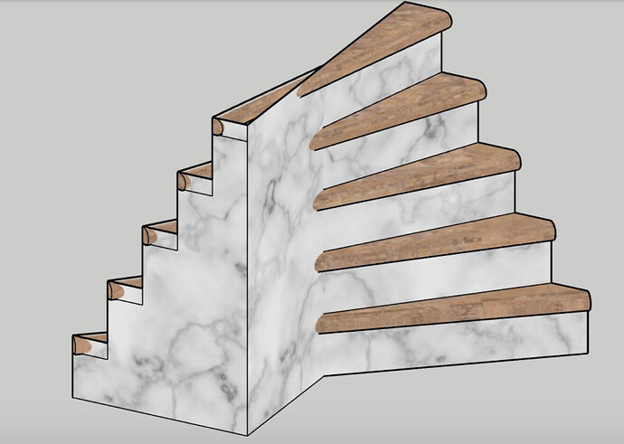

It can be very complex so let me give you an example. I try to make stair by codes. When user draw a possible stair, no error happen but when user draw an impossible stair I receive error when draw face1. following you can see an example for impossible stair. I check many times and error just happen when logically stair cannot exist. One solution is I try to limit user for this error that will have many different condition and I should write some codes for each one and other solution is using this error.

Yes you need to use input validation on the values from your input box fields to prevent the user from drawing invalid stair configurations. You test the input values before your code attempts to draw geometry, and if the values are bad then you display a error message box to the user and redisplay the input box.
