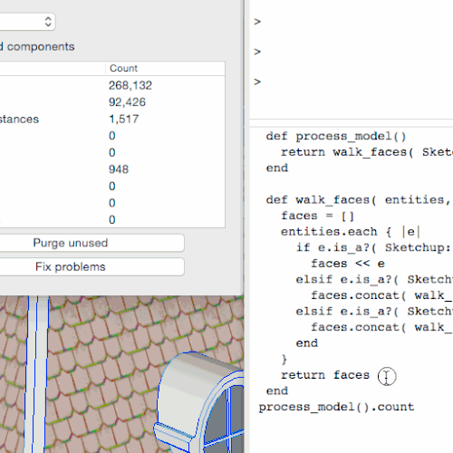

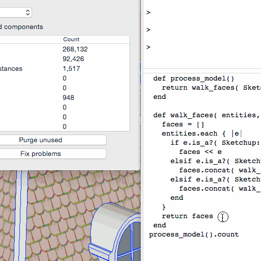

ok, I found the answer in a bit of modified [TT code][1] found at SketchUcation…
I just added the .count…
def process_model()
return walk_faces( Sketchup.active_model.entities )
end
def walk_faces( entities, transformation = Geom::Transformation.new )
faces = []
entities.each { |e|
if e.is_a?( Sketchup::Face )
faces << e
elsif e.is_a?( Sketchup::Group )
faces.concat( walk_faces( e.entities, transformation * e.transformation ) )
elsif e.is_a?( Sketchup::ComponentInstance )
faces.concat( walk_faces( e.definition.entities, transformation * e.transformation ) )
end
return faces
end
process_model().count
[1]: Best way to get all Face's in model? • sketchUcation • 1
