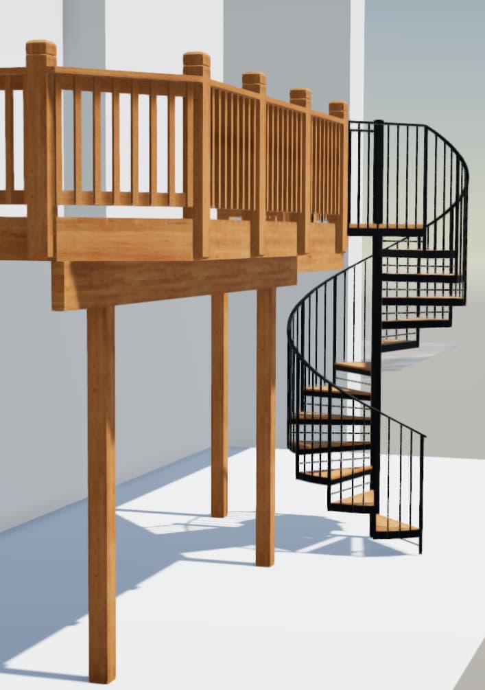

For comparison:
Just the Deck Board
Not Unique:
Unique:
TC Vis (had to do it! No rendering adjustments):
TC Vis Unique:
Even with the repeats in my opinion the texture shifts make things look better. Started thinking more in terms of material takeoffs. Color / Materials and rendering change things up a bit (went through manually and made unique… not efficient).

that looks good !
(especially for a tool in development)
yeah, the unique variant looks more… natural / random. but only because you have nothing on it, the focus is the deck.
if the focus had been the space you create on top (adding a few things, a plant or two…) then the trick wouldn’t be needed I think. sure, the non unique version looks a bit uniform, but add a barbecue, table and few chairs, nobody will pay attention to the pattern
