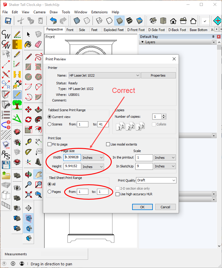

One of the most aggravating things about SketchUp is the difficulty of printing a model, either"Fit to page" or “Scale”. Having to change the SketchUp window size to get a correct printout makes SketchUp look amateurish. I would have hoped that a few resources would have been spent fixing this 15+ years after SketchUp introduction. Every new user stumbles on this and has to go to the internet to discover how to get a simple print out. But hey, we have a new toy, SketchUp Free.
Joe…
It has been solved years ago with the introduction of the LayOut application. There is no need to print directly from Sketchup. Just like AutoCad, in the 1900s you needed to print from the model space view, nowadays practically everyone uses the paper space layouts.
Give me a break! A Make user is supposed to pay $695 just so they can print? I am a Pro user and few of my models make it to LayOut. I just need a quick scaled drawing for my shop. LayOut takes time and moving a model to it just to get a scaled drawing is ridiculous.
Joe…
But you CAN print to scale from SketchUp. Just follow the instructions. They have never failed me.
And, 98% of the reasons why printing to scale from SketchUp fails (it fails in LayOut too for the same reason) is this:
PERSPECTIVE HAS NO SCALE.
Next time, take the time to make a template which you can use, this will save you time in the long end!
Why is it that people who love SketchUp feel the need to protect it from feedback and constructive criticism? Is it a religious thing?
I love SketchUp too. I wrote a book on SketchUp (https://www.amazon.com/Woodworkers-Complete-Illustrated-Guide-Sketchup/dp/1440342016). In it I tell the reader SketchUp was the best thing to happen for woodworking. But it does have a lot of shortcomings. And please don’t try to teach me about drafting. I learned about perspective vs. isometric in my college drafting class in 1963. I am an engineer and I thoroughly understand it. I also have a LayOut template, but that doesn’t make it any less bothersome to export a model to LayOut.
Here is the problem with SketchUp printing:
  1. One should not have to go to another application to get correct printing results, or to print at all. Especially if you have File commands Print SetUp, Print Preview and Print.
  2. In any computer application “Fit to page” means enlarge (or shrink) the useful content such that it uses the maximum area of the print sheet. Seems obvious, but not to SketchUp.
  3. The “Scale” fields are greyed out. To select them you have to close the dialog box, Select Camera > Parallel Projection, re-op the Print Preview dialog box and then set up the “Scale” parameters. It would make more sense to allow the user to select “Scale” radio button and have SketchUp temporarily select Parallel Projection, or at least place a note on the Print Preview dialog box that the “Scale” parameters will remain greyed out until the user selects Parallel Projection. I can’t tell you the number of new, and frustrated, SketchUp users I had to guide through this. It is not obvious at all.
  4. When printing to scale, the amount of white space should be a non-issue. And when you enter a scale the “Page size” should be correct. See slides 1 through 3 attached. Notice on slide_1 that SketchUp will output 28 pages when only 1 is required. Also notice in slides 2 & 3 that the “Page size” is incorrect until you place your cursor in one of those fields.
Have you ever looked at how many different responses you get when you Google “how to print to scale in sketchup”. I myself have at least four of them out there. My point is that this issue has been around for 15+ years with no attention, just like many other SketchUp issues (e.g. the inability to delete a component in Ruby code even though you can from the user interface). The printing problem in particular is an example of things that makes SketchUp seem amateurish; makes it is hard to take it as a serious application.
So go ahead. Protect SketchUp from constructive criticism as if they are children and can’t take it. If we fail to expose them to constructive criticism we are doomed to get toys like SketchUp Free.
