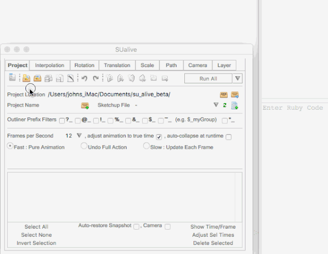

The OpenProject filebox filenname field shows the name “SUalive.ydprj” on Windows as you may see above but I don’t see that same field on your OSX file name. Where is it?
SUalive use the UI.openpanel method like following
return_file = UI.openpanel(“Open Project”, var_project_location, “SUalive.ydprj”)
Looks this does not work. What is the right way on the Mac?

SU15 and greater I replaced openpanel() with directory_select() as shown below. So no longer need to select project file. SU8…SU14 keep openpanel() method. Good enough for you?

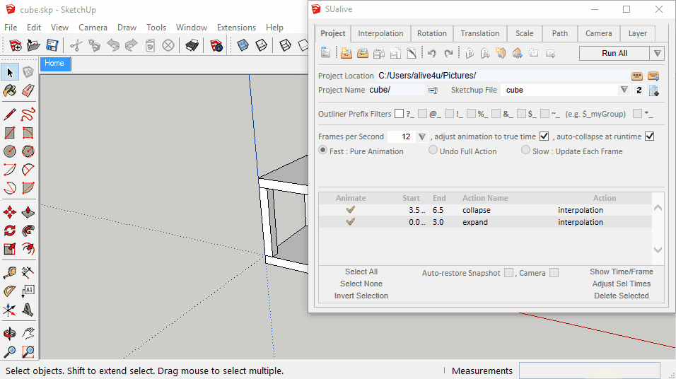

Back to the bug previous project load. The Ruby console is meant to tell us where things go wrong but the test should be done as follow due to a main module scope variable - animated gif below. in short
1 - with cube project shown - no need to load the model.
2 - check MenuLeft Preference/Project/auto-load previous session project.
3 - click OK then quit SUalive and SketchUp as well
4 - reload SketchUp and show Ruby console then run SUalive
This way you should no see ‘Collapse’ and ‘expand’ in bottom timeline.
May you show me what your console tells us?

Both outputs perfectly match. So the issue is likely to be multi-document feature
No it doesn’t. Prefrence/Project/‘auto-load model’ must also be checked to achieve but fortunately you didn’t do!
Not sure I get a full understanding of what you tell me. I’m going to rephrase it for the sake of clarity. Please correct if needed.
So SketchUp on Mac is multi-document which means more than one model opened in a single session of SketchUp whereas Windows version may open several documents but each one in separated SketchUp.
…other open documents…
SUalive read and check current model at load time. No issue on Windows as SUalive read a single document. On the Mac it looks like SUalive reads and checks all documents. That check generates the unwanted save dialog at model close time.

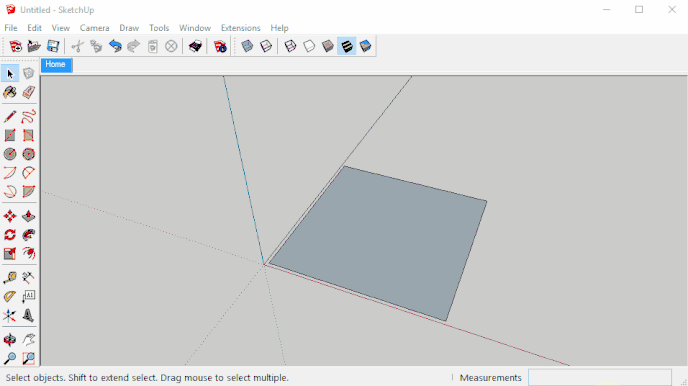

I open SU on a new un-saved empty skp, which is my default…
if I click on SUalive, in Extensions and immediately cancel the WebDialog…
when I try to quit SU, I get a Save dialog…
if I don’t cancel, but load an animation skp and run it…
when I try to quit SU, I get two Save dialogs…
one for each of the open documents…
to avoid this happening you need to confirm it is a Project skp and that it has been actually modified…
I honesty, I should be able to open and run the animation, without getting the save dialog as happens to running a native animation…
from your gif’s it looks like the Win version modifies the model as well…
