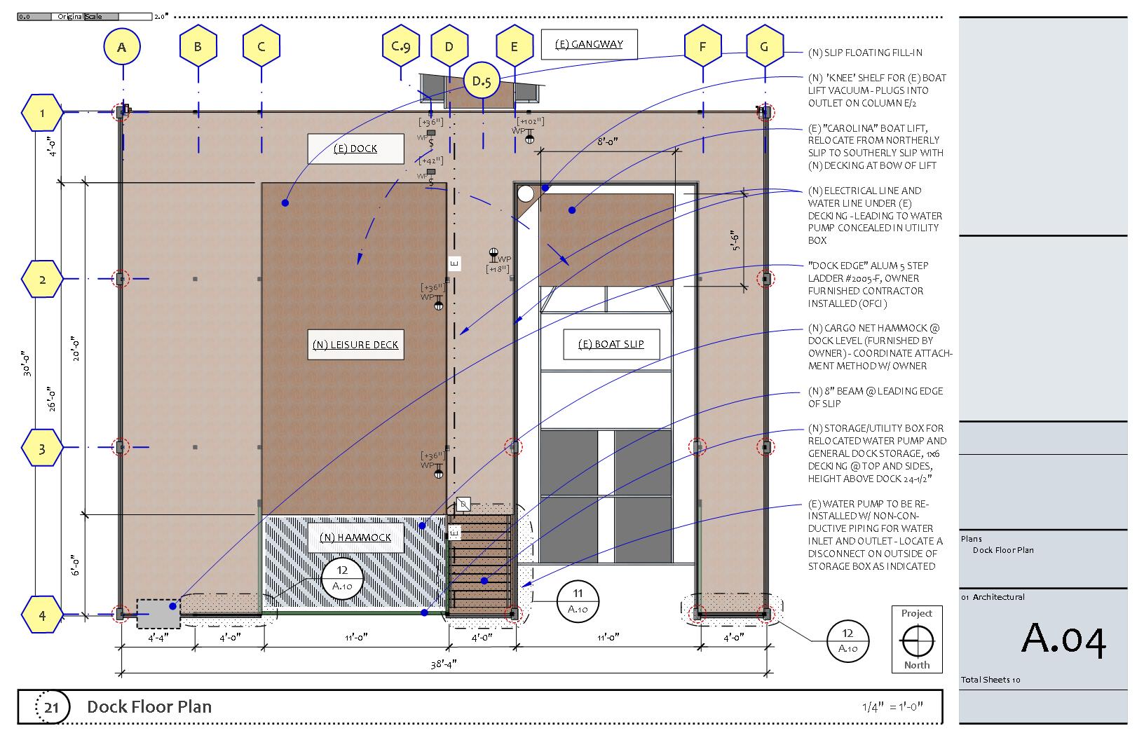

Project is nearing construction phase start.
Here are updated drawings with some bidding & review revisions,
directly exported from LO in *.jpg format.
Looks great! I think it’s going to be hard to get the Catalina 27 into the slip. ![]()
Thank you.
Those sails and masts can sometimes be a bit mystifying. ![]()
But, always a lot of fun. I have always enjoyed J/22’s.

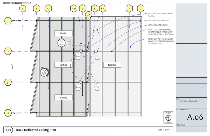

Very nice! Did you make the “Jelly Jar” light fixture or get it from somewhere? For a true reflected ceiling plan, I assume you take a section cut looking up and mirror the scene in Layout?
Thank you.
I am looking forward to the next phase of this project.
Thank you.
The Jelly Jar (vapor tight fixture) is a re-modeled 3DW find by referencing a Lithonia model cut sheet, I selected to specify.
Yes, the RCP is an up looking section cut of the base model and using “Flip Left - Right” in LO.
