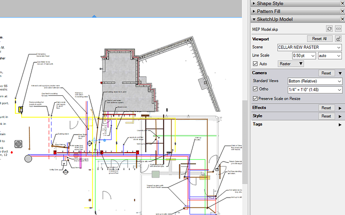

It would help if you share the LO file so we can see how things are set up. If you’ve modified scene properties for the viewports in LO, they will override the scene properties that are set in SketchUp so the viewports won’t correctly reflect the scenes in SketchUp.
So any modifications you’ve done to the viewport will override those properties from SketchUp. Changing the scene properties in the model won’t have any impact on the viewport because you’ve told LO you don’t want those scene settings in the SketchUp model.
In this viewport you’ve overridden Camera, Effects, and Style properties so if you changed any of those in the model and updated the scenes, those changes aren’t going to show in LO until you update the reference and click Reset for the properties. In the case of the Camera properties, your override also means you wouldn’t see a change in the viewport if you select a different scene. Best practice is to avoid modifying Camera properties for the viewports in LO.
Another thing I notice about your LO file is the fairly huge number of .skp file references. That could lead to confusion if you are editing one .skp file but a different one is actually the reference. There are quite a umber of unused references so purging would help. Even without cleaning up the SketchUp files purging the unused references reduces the LO file by about 75%.

You can disable the ability to edit camera position in the viewport. The tickbox is in Preferences>General. By default the box should be unticked and you should leave it that way. That’s a feature that was added in the last few versions and wasn’t available in 2016 or earlier.
There was nothing else in earlier versions to prevent modifying scene properties. Now you have more options to modify scene properties. Some of them such as tag visibility and line style by tag give you great power and can make your SketchUp models much simpler and easier to manage. Other settings, especially some of the Camera properties can wreak havoc when you need to make edits to the model or change scenes. You can change Scale for Parallel Projection scenes but you shouldn’t ever need to double click into a viewport to zoom, orbit, or pan and you shouldn’t ever need to select a Standard View or manually tick the Ortho box.
