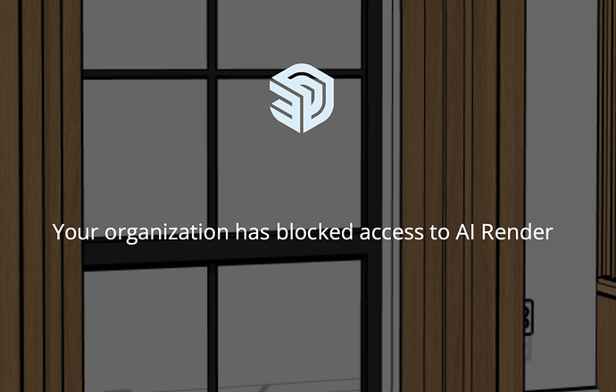

Your organization has blocked access to Al Render
Went to test out the latest Diffusion Render extension that was updated via Extension Manager, and got this message: “Your organization has blocked access to Al Render”.
I checked the new account admin pages on Trimble, and couldn’t find any related settings. I’m the org owner, so I would have had to disable this, and don’t recall messing with any such settings.
The help files don’t seem to reference this either. https://help.sketchup.com/en/sketchup-diffusion
Does anyone know how to work around this?
A few services have been disrupted by AWS outages today. It may be that it affects access to Diffusion as well. Here’s a page that monitors various outages:
https://downdetector.com/status/aws-amazon-web-services/
Hi fbonomo,
Do you still see this issue?
Organizations can block Diffusion by blocking the following URL:
https://diffusion.sketchup.com.
This will trigger the message.
Best,
Jacques
Thanks for the suggestions. We’re not blocking anything on our side of our internet connection.It appears to have been timed with the AWS outage, so that may have been the culprit.
