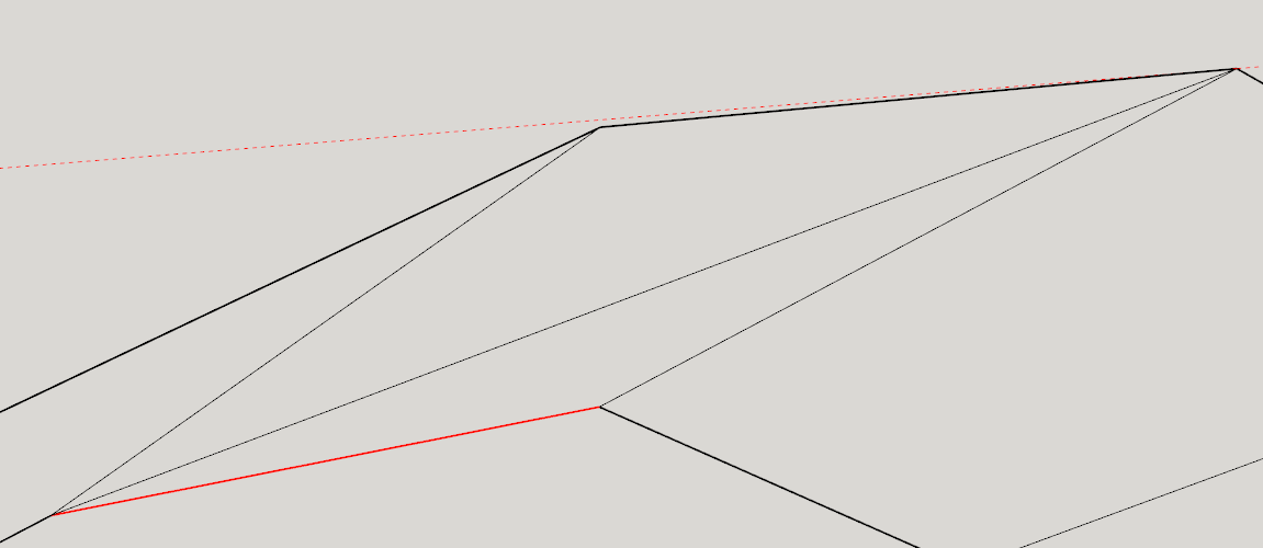

Why are these points not coplanar?
The corresponding edges aren’t parallel so the corners can’t be coplanar. The guideline is parallel to the selected edge. Notice it isn’t parallel to the near edge.
